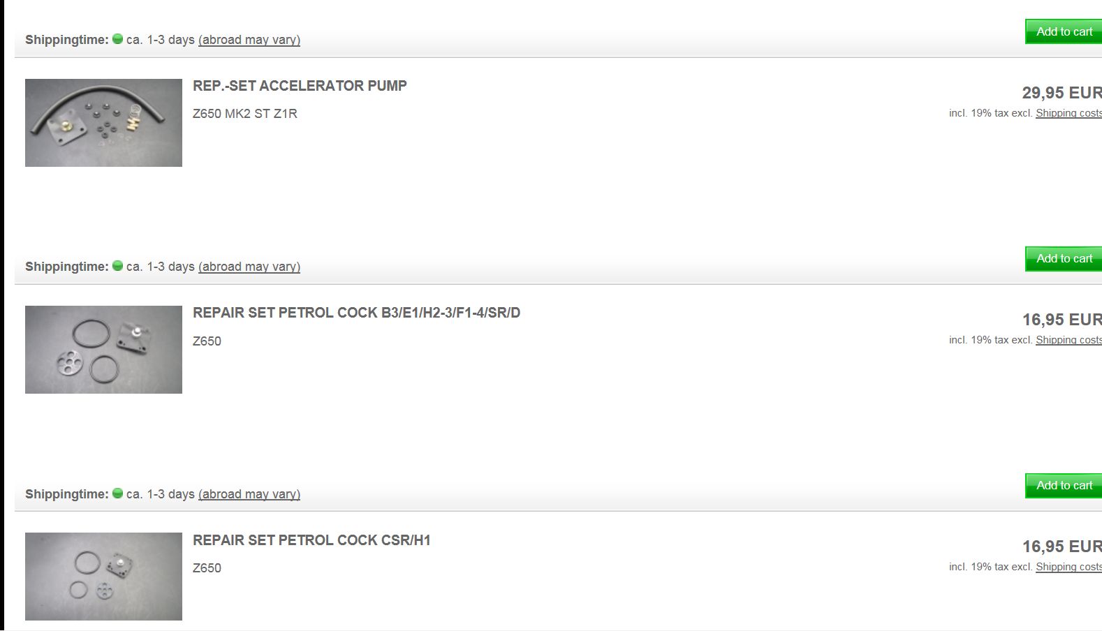

This guy has all you need, non vacuum/vacuum repair kit and petcocks.
z-fever.de/shop/index.php?cat=c324_fuel-...fuel-system-324.html
The following user(s) said Thank You: GS963
