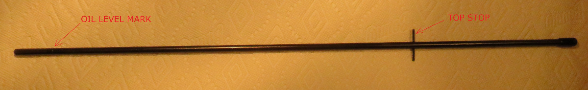

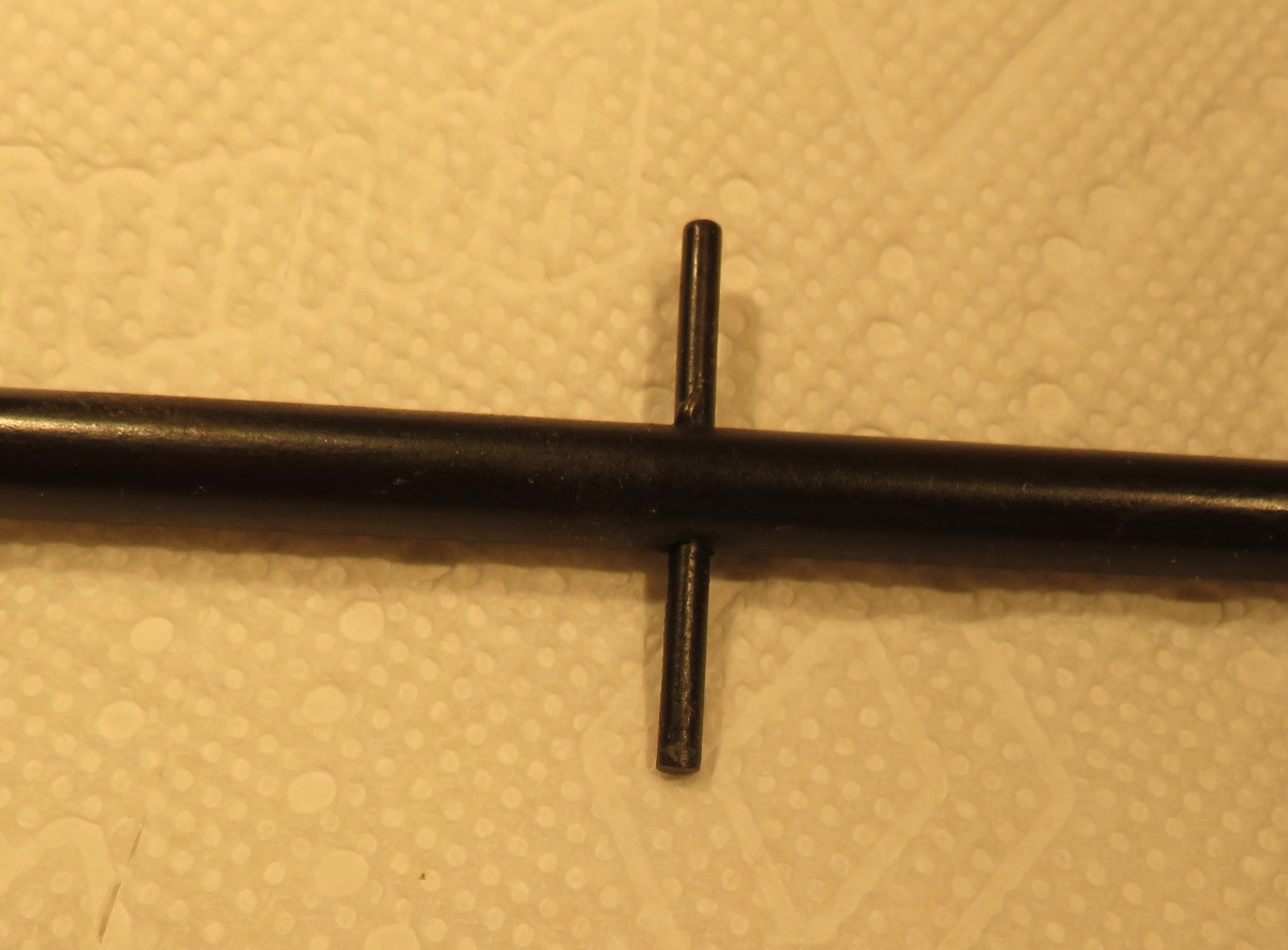

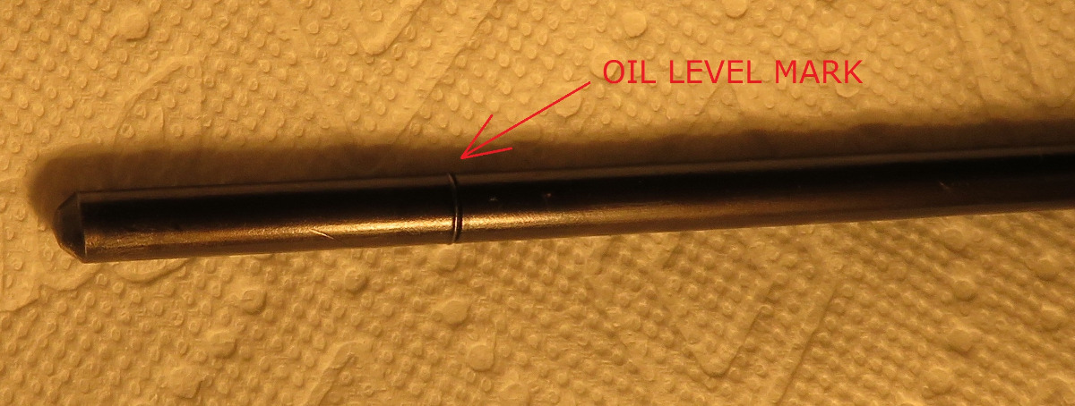

I made a simple measuring rod for adjusting the fork oil level in my bike. See images below. Ed

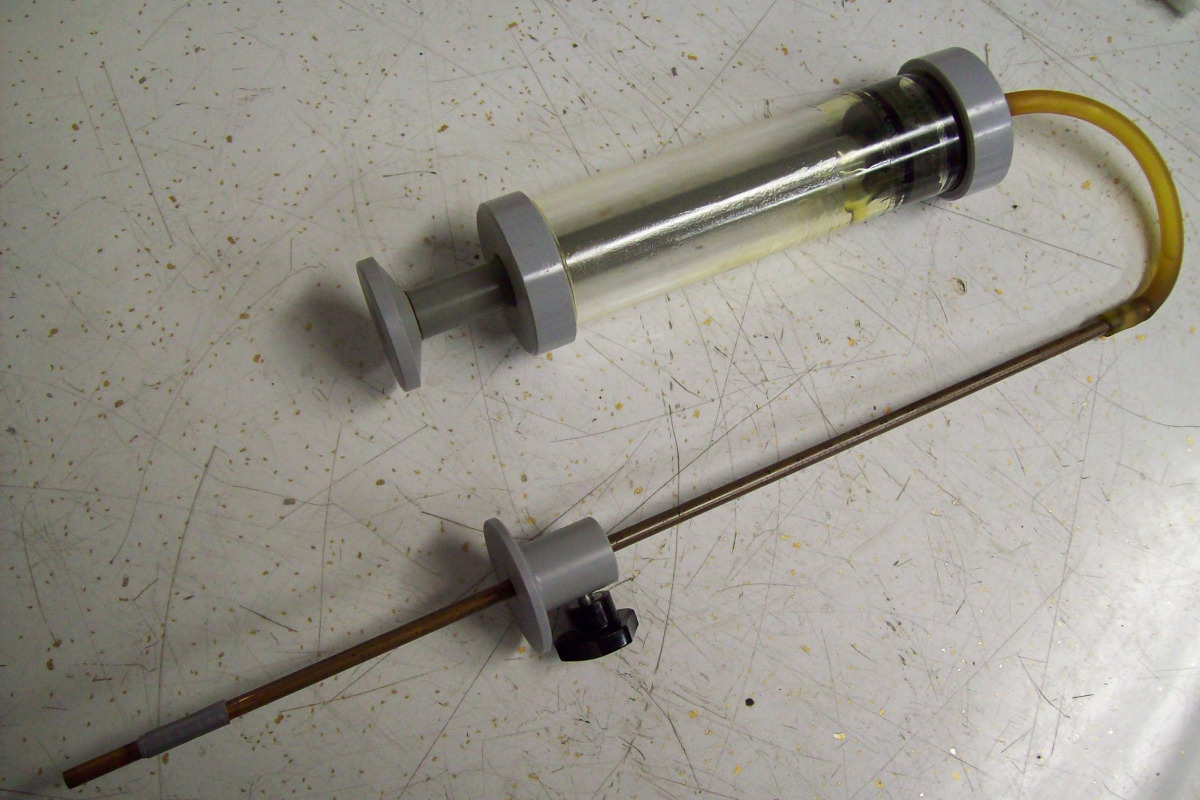

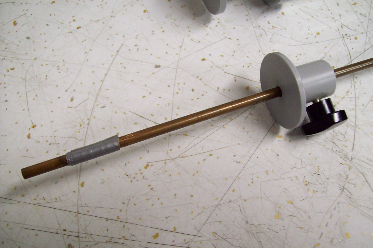

Amazingly Ed, I came up with an almost identical set up. Then I thought perhaps my invention would displace too much oil. So now what I'm thinking is making a vacuum hose the correct length and use a Mity Vac to suck the oil level to the correct level. This would mean of course and over fill to start with. Another friend suggested going to a Junk Yard and picking a long engine oil or transmission oil dip stick. Still trying to figure that one out. I like the idea of using a washer to keep the what ever from going down the tube. The 60000 was a typo, I meant 6000 miles.
The FSM for my C14 doesn't suggest changing fork oil. I had it do when she went in for a valve adjust and some other things I wanted done. The service manager said the only time they had heard of changing the fork oil on a C14 was when it had a seal leak.
I also know the old forks can have some pretty nasty looking fork oil where as I was told the fork oil in the 14 was still pretty clean.

Suzuki sells a neat tool for setting the level of your fork oil. You overfill the fork leg slightly, insert tool set at the prescribed oil level, and suck the excess oil out!!! Quick and easy way of setting your fork oil level. Fork leg should be perpendicular to the ground for a super accurate measurement.

Looks like Pro Motion and a couple of others make something very similar for less than $20.00. I think my trying to figure it out has ended. Thanks Tim
