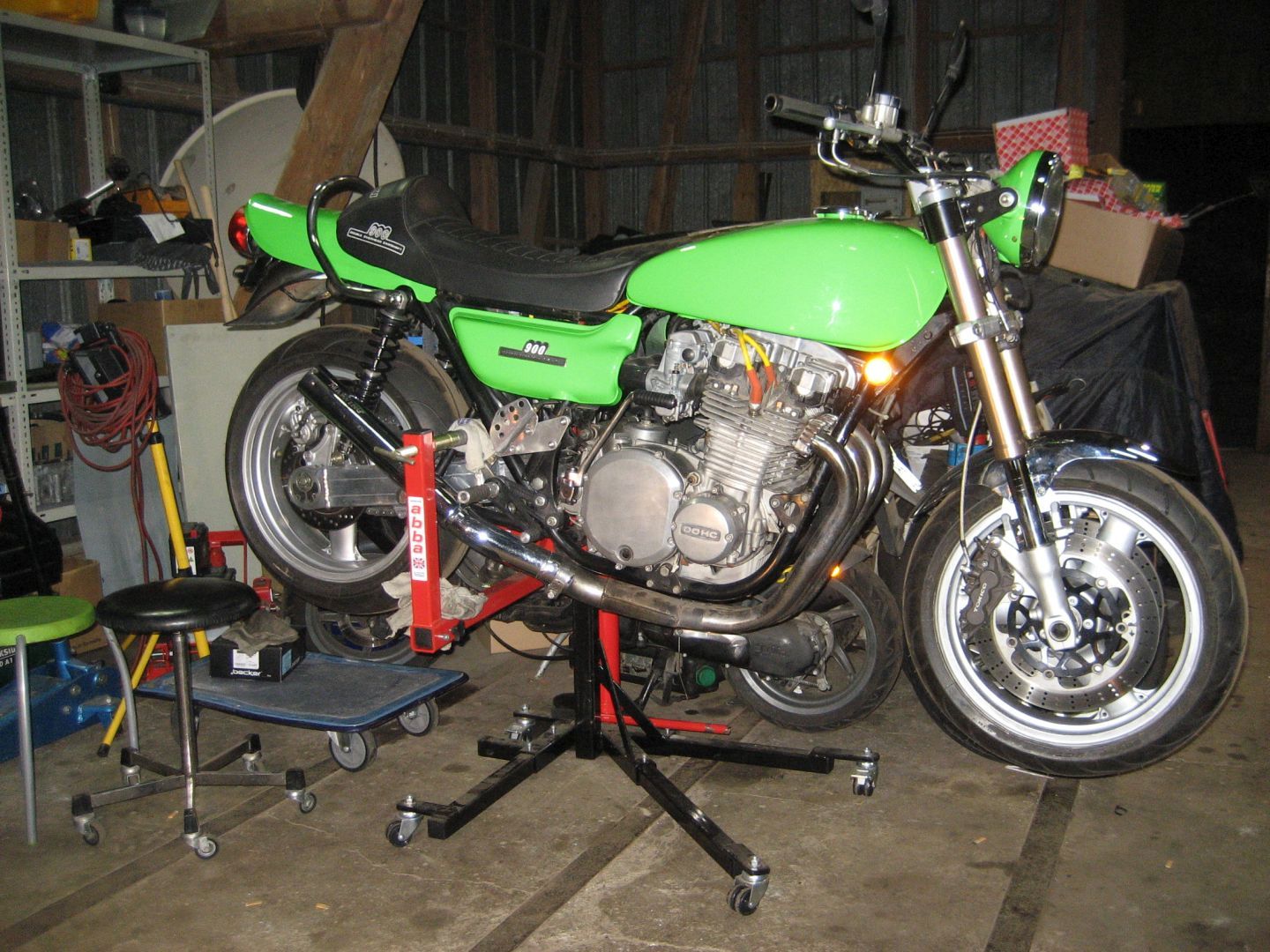

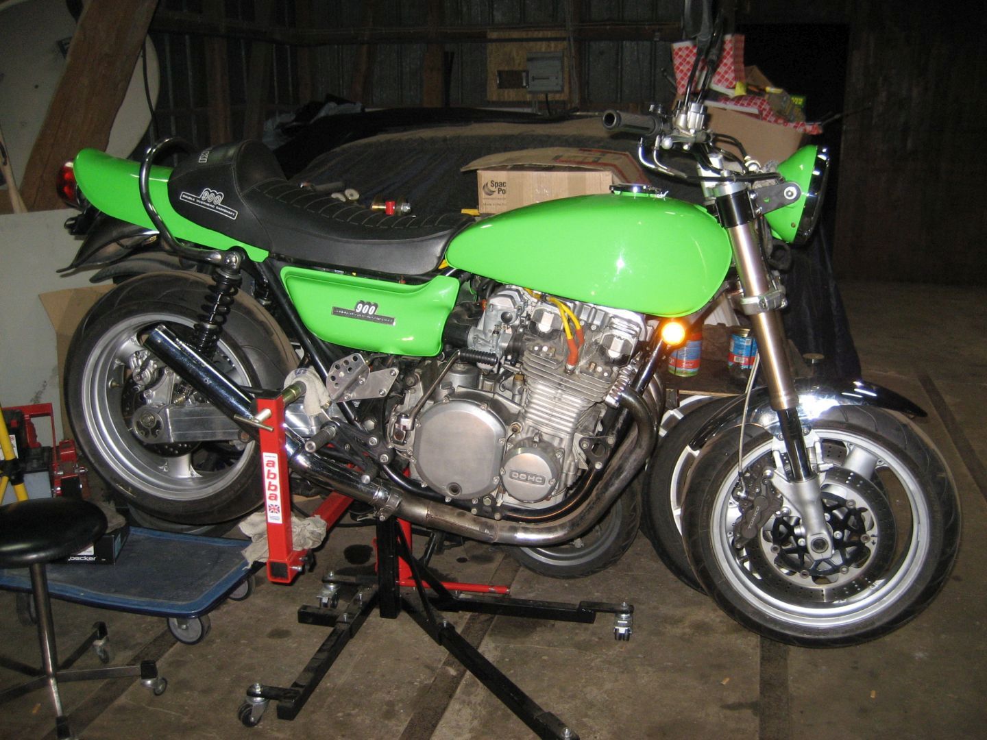

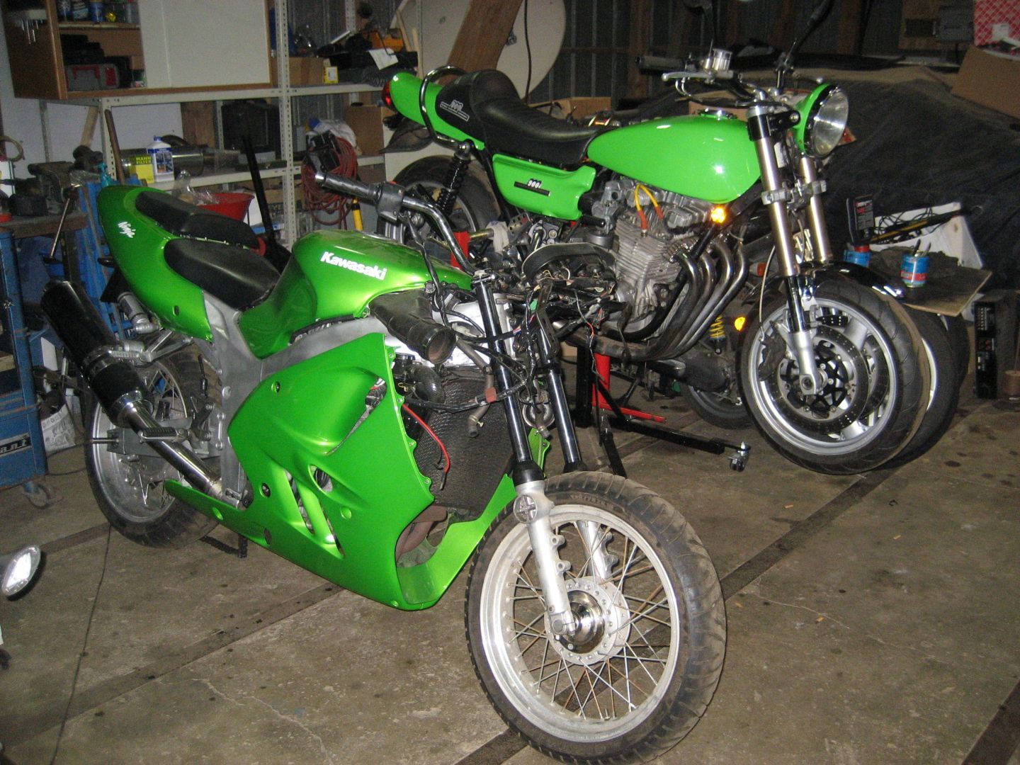

You can use a single (1/2) or twin disk (5/
MC to bleeding a twin disc system.
On my project bike i bleeding a (ZX9R) 6-piston twin disk system with a Z1B single disk (1/2) MC with no problems.
