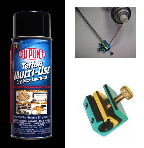

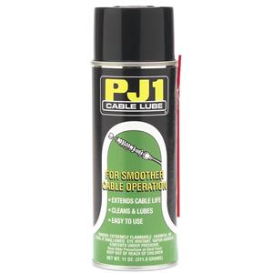

The Motion Pro luber will make the job MUCH easier and less messy
www.motorcycle-superstore.com/4838/i/motion-pro-cable-luber
Plus---
Plus---

Cable luber is readily available and relatively inexpensive to do a quick thorough job on any cable.
Enables quickly blasting lube throughout the entire length of the cable without having to rely on gravity flow from a pooled source as described in many service manuals.
