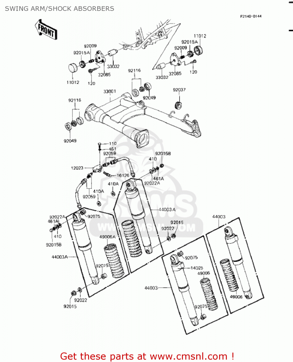

I'm probably going to have to do what this guy did with his pivot bolt.

precisely.
but,my thought would be to machine 32085 and 33032 as one piece that the bolts would then go through like arnolds.
then you would install the axle in the arm slide the spacers over each end,then install the whole assembly in the frame and then put the newly machined frame fittings in and tighten the bolts and your done.
