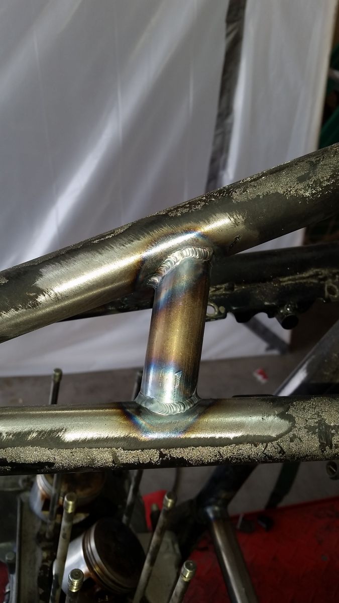

28 Jul 2015 11:12swest wrote: I've been cutting pieces for my frame so when I have the head off, I can weld them in. I'm tired of the "frame flex" too.
The hardest ones to fit are the 2 under the tank.
