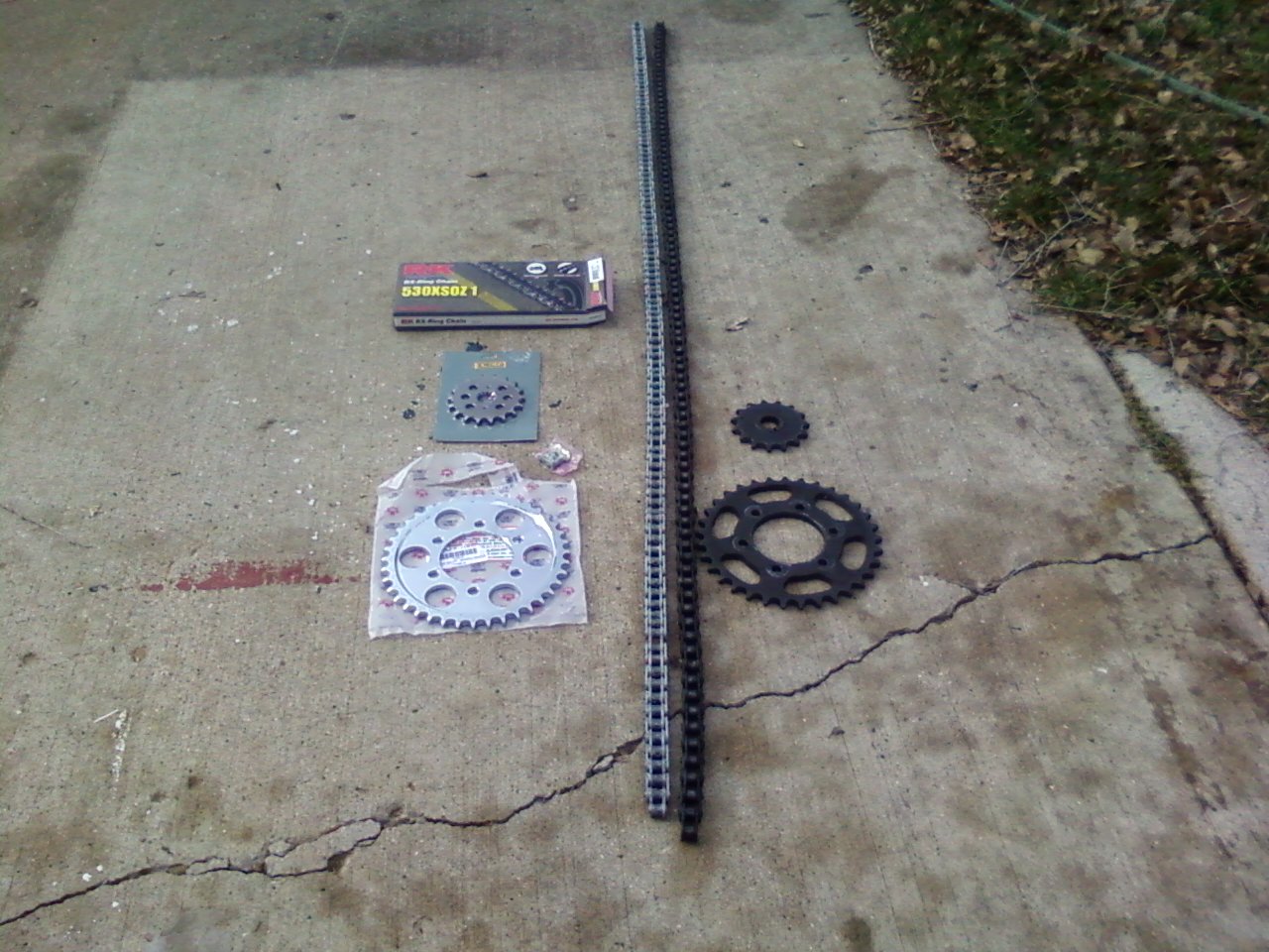

Get a hold of Rob at Z1 enterprises He'll set you up with everything you need, just make sure the front sprocket has a hole for the lock washer.
And don't forget the lock washer
NEW and OLD
