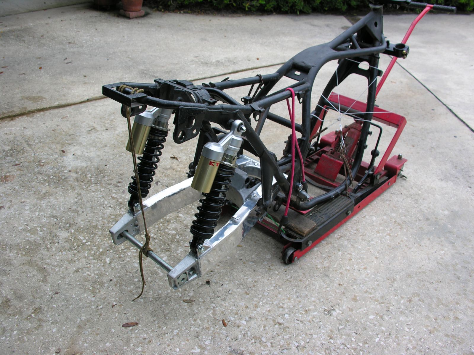

Just make a spacer to take up the difference with the later model swingarm pivot bolt and the 16 mm Z1/KZ pivot bolt diameter. I had a pal make a spacer on his lathe to take up the 20 mm Suzuki Bandit 1200 swingarm pivot bolt size and this KZ's 16 mm pivot bolt. I also purchased swingarm-to-rear-shock brackets from PMC via Z1enterprises.com and had them welded on to fit Kawasaki ZRX1100/1200 shocks.

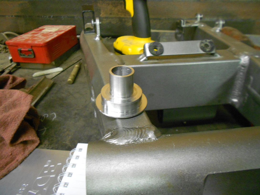

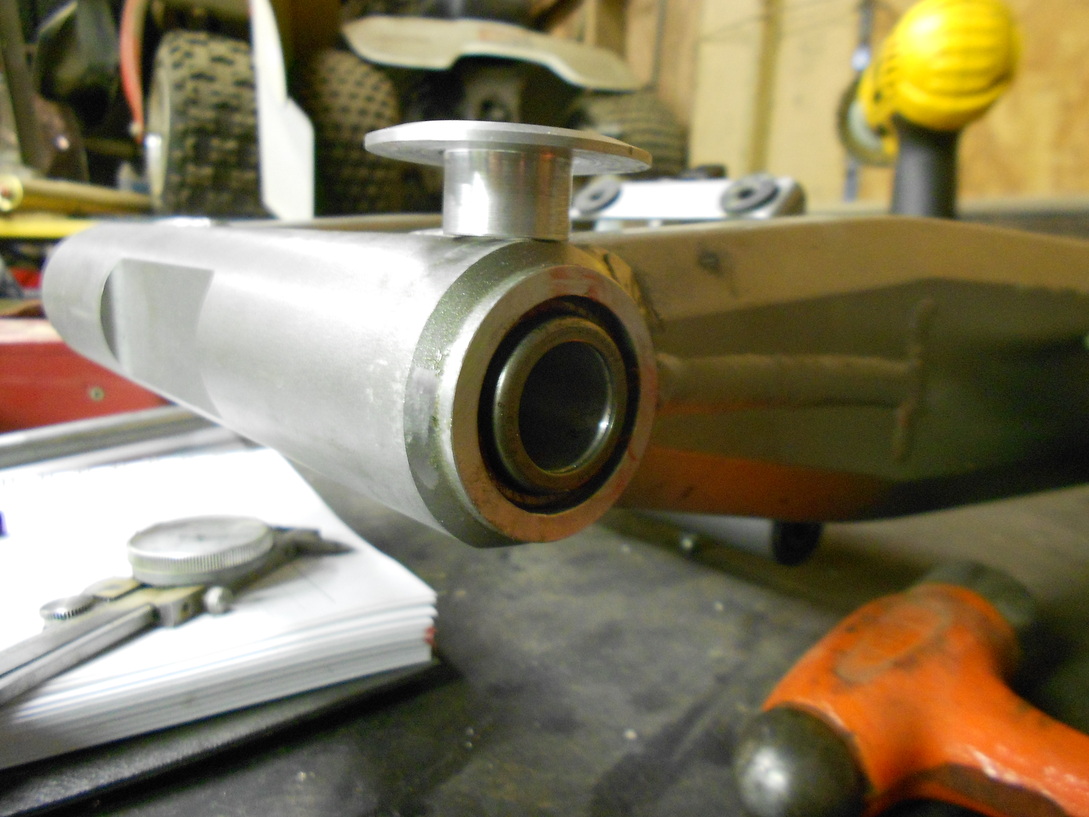

here are some top hat style bushings that i machined out for benhurmx's zx636 to kz swingarm conversion.
this seems to be a very effective solution.
to the large diameter pivot bearing blues
hth,
hth,

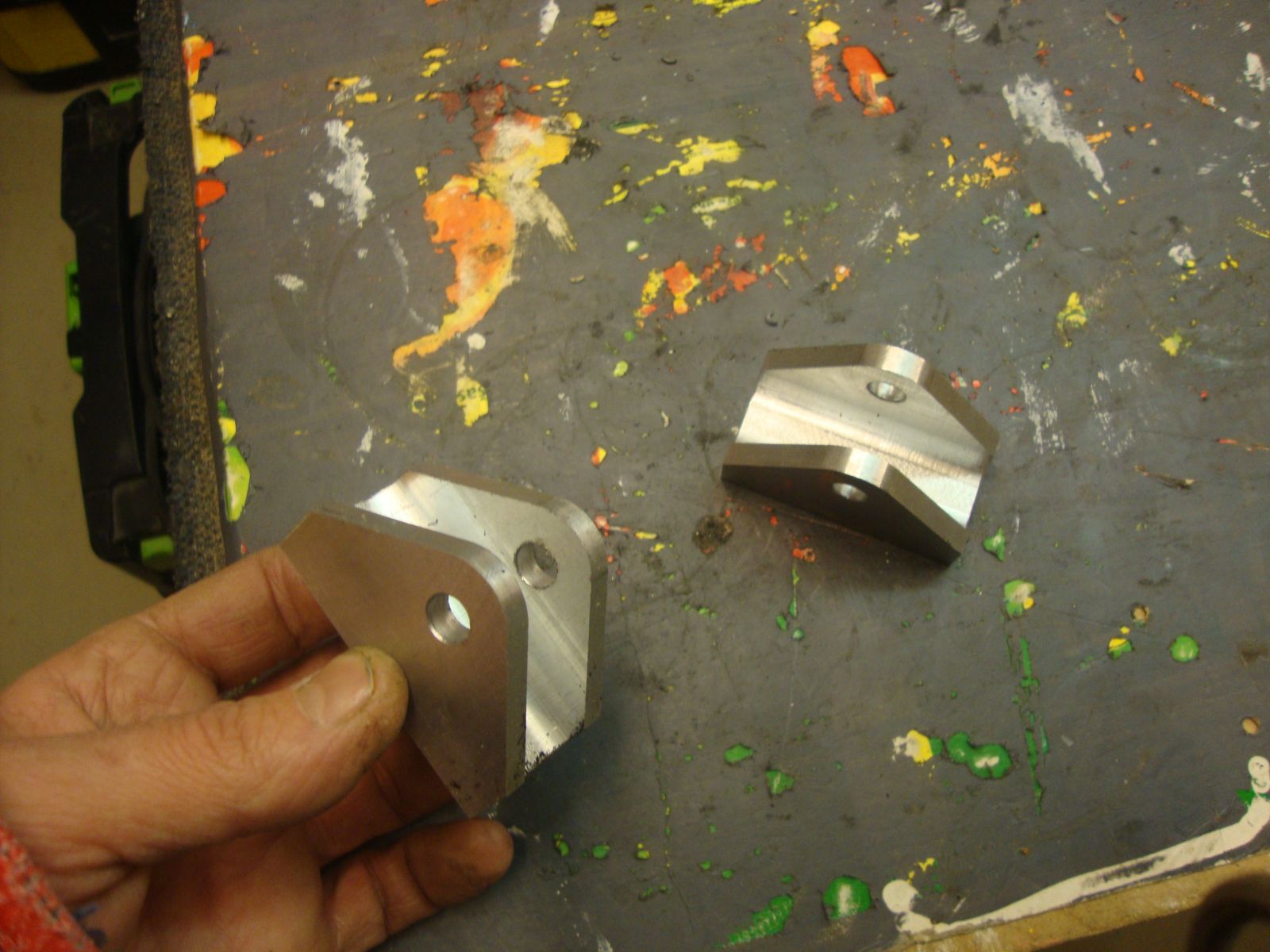

i have welded a few sets of these on some zx arms before.
tracdynamics.com/products/weld-on-shock-towers

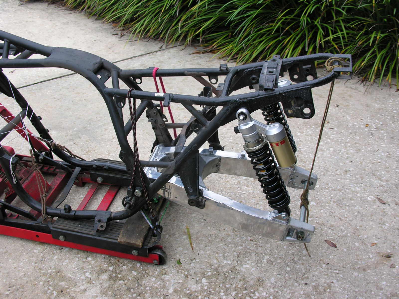

here is a set i welded on revboys zx arm.
you will also have to address the caliper shock interference scenario.
here you can see i modified a stock caliper mounting bracket also.

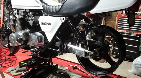

Just ordered a set of shock mounts from Tracdynamics. Thank you ALL for pointing me in the right direction. Almost done with my ZX636 to KZ swingarm swap. Me happy!!!!! Got a nice ZX636 polished swing arm from Ebay, $45.00.....free shipping. Cannot beat that. bought a Calfab swingarm back in the early 80's for my LTD1000. cost me $300.00 for the swingarm back then.
Work in progress.
Work in progress.

Question guys, i'm in the process of getting the final details addressed with my swingarm swap out shown above. So, my question is... would it be safe to add a spacer behind the counter shaft sprocket on my KZ1000P to realign it with the rear sprocket or is it better to go with an offset counter shaft sprocket? Looks to me, that adding a spacer behind the counter sprocket would result in correct chain alignment as would an offset counter sprocket. I am shooting to run a 180 rear tire, hope it all fits!!!
Just received my shock mounts from tracdynamics, I need to have them welded on. Getting close to completing ZX636 swingarm swap. Cannot wait to see it all completed and back on the ground.
