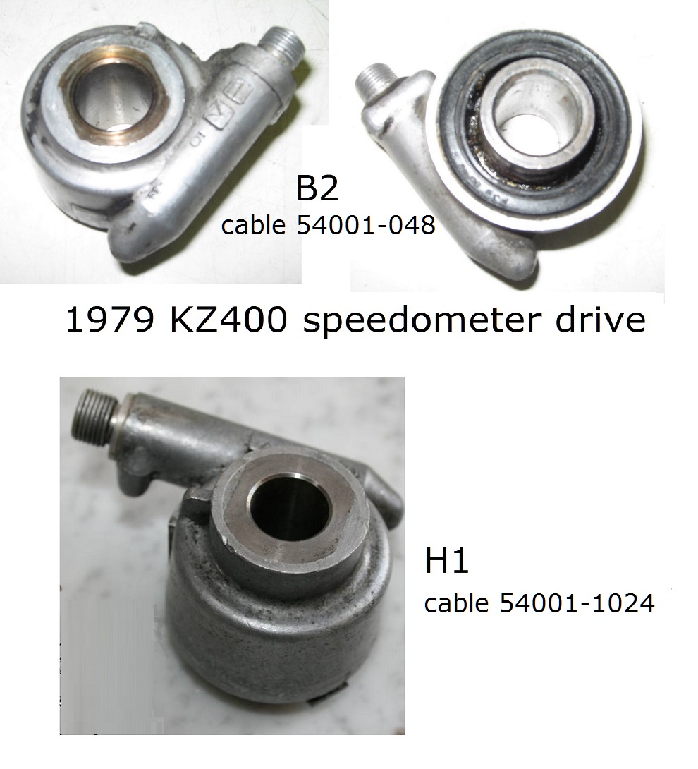

06 Jul 2014 04:58 - 06 Jul 2014 04:58Can you post a photo of your speedo drive? Does the cable fit the speedometer?CafeKid wrote: So I recently purchased a third party speedo cable from my local dealer and the thread for the cable is a bit too large to fit the threads on the speedo gear box. its just slides right over the threads instead of twisting on.
I've triple checked the part numbers and they seem to be correct. Could i have a Speedo gear box from another year kz on mine? I'm confused as to why this wont thread properly. Thanks!
If you don't have a pic, eebbaayy is handy for stuff like this --- check to see if other KZ400 drive units look like yours.

Martin_csr it fits the speedo but doesn't fit the gear housing on the front hub.
'79 KZ400

Per kawasaki.com:
41078-1004 GEAR BOX ASSY 1979 KZ400-B2
41078-1005 GEAR BOX ASSY, METER 1979 KZ400-H1
These ebay pics might help identify the unit at hand.
