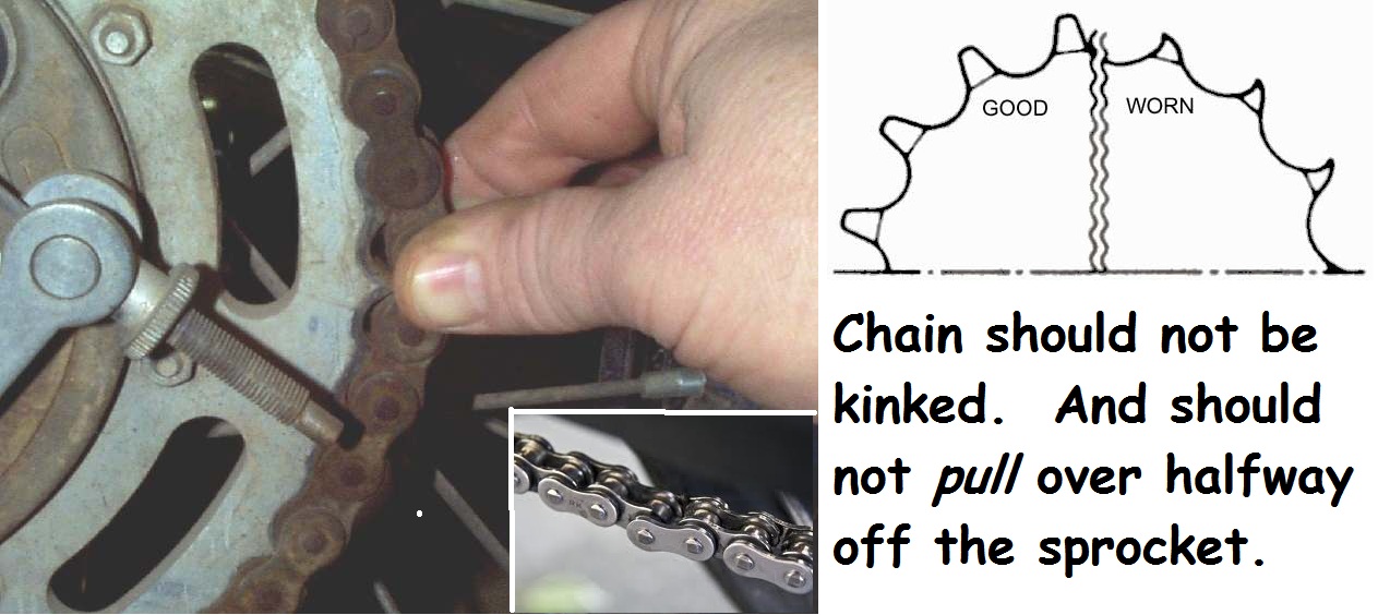

If the existing sprockets aren't worn, but the chain's o'rings have deteriorated, seems reasonable to replace the chain, and use the existing sprockets.
But 10,400 miles may be reason enough to replace at least the rear sprocket.
Perhaps the rear sprocket pictured doesn't actually have 10,400 miles on it.
The front sprocket is often more durable than the rear, but it's relatively inexpensive.
