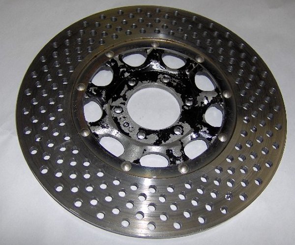

Drilled disc

These folks can drill them and can resurface them. ed
www.truedisk.net/Home.php

Is the drilling supposed to increase cooling rate on the disk?

I think the main purpose is to improve wet braking. In theory the water has a place to go rather than making the pads hydroplane on the rotors. Can't really prove it by me since I have never had problems braking in rain even though my rotors are not drilled, but I suspect there is some advantage to it since so many newer rotors are drilled. Ed

Interesting, never thought of that. I did net research and the two reasons I saw listed repeatedly were:
1) Improves cooling in applications where you do severe braking because air going through the holes.
2) Improves "grab" because the pads can grab the edges of the holes better.
Obviously, the drilling reduces the rotor mass so it would saturate with heat sooner.
Some said that for "normal" applications, better not to use them but they help for racing.
I have never tried the holes but since bike rotors ride out in the air, I would think they would be getting pretty good airflow (?)

I switched to dual drilled disks on my bike because I could not get the single non drilled disk to quit squealing when I stopped :pinch:
They are working great and are very quiet
TRUE DISK looks like they know what they are doing

01 Jun 2014 06:43I did mine RC style 3 rows of 36 5/16ths holes many years ago in a machine shop I worked at ...... knocked off around 1 and a quarter lbs.
