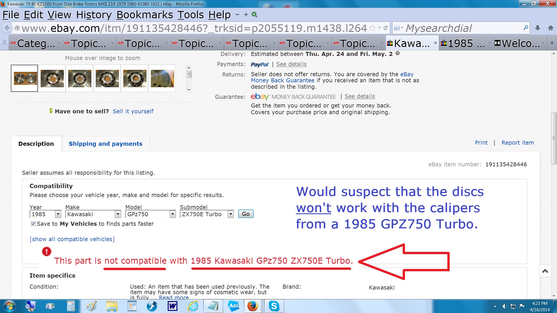

No eBay APP ID and/or Cert ID defined in Kunena configurationNo eBay APP ID and/or Cert ID defined in Kunena configurationNo eBay APP ID and/or Cert ID defined in Kunena configurationThese rotors?
And these calipers work together?
and this master cylinder?
While the 5/8" master cylinder should be okay for the calipers, am thinking the discs would not be okay with these calipers.
Besides the listed discs having a different part number than the stock discs on a 1985 GPZ750 Turbo, here's an excerpt of info from the ebay seller:
SeattleKZ wrote: These rotors?
