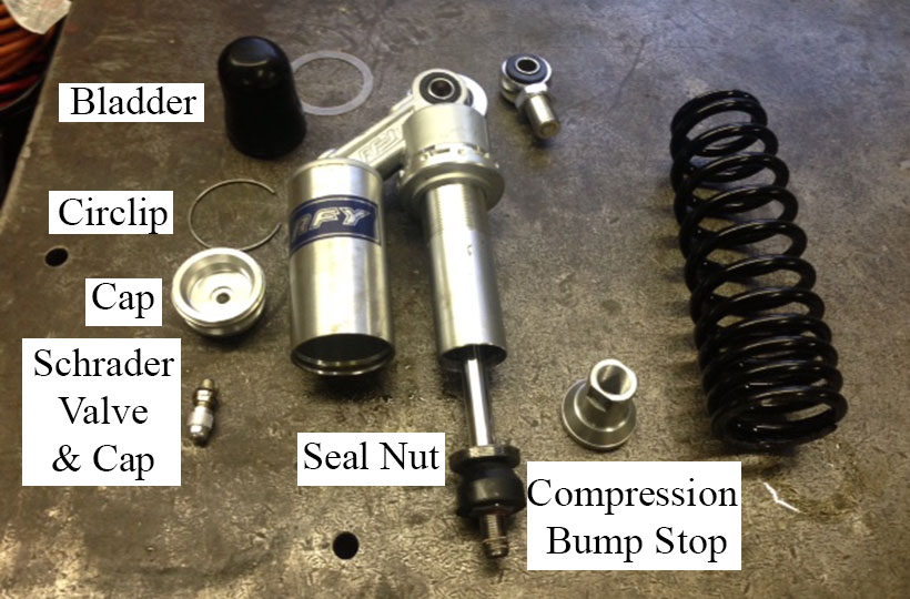

Here is a semi-exploded view of my shocks. Give it a look then scroll down.
The above photo shows the shock almost completely disassembled. All that remains is the shock seal, shaft, and piston in the shock. The bladder fits on the cap and is pressurized externally using the Schrader valve. The gas in the bladder does not come into contact with the damping fluid. This bladder colapses as the shock shaft displaces oil. The circlip holds the bladder and cap assembly in the reservoir of the shock, and bladder seals to the interior of the reservoir preventing fluid from escaping. Upper left in the photo is a semi-translucent washer. This washer goes between the upper spring perch and spring. I assume it’s primary function is to provide a surface that won’t chafe as the spring moves on the perch do to compression.

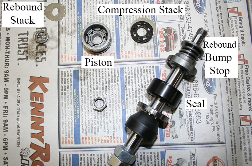

Here you can see the entire shock rod and all of its components. The piston and stacks are of most interest, though the components are all pretty standard. Which, in my opinion, is a good thing. Overall quality appears good, though there were challenges in disassembling the shock this far. The overabundant use of high strength thread locker was the main obstacle. A nice addition to the shock is the rebound bump stop which has a spring and should help prevent adverse wear and tear when your wheel suddenly extends to full droop.
My impression is that these shocks are more than usable. They do appear to be copied from an Ohlins shock. All things considered, they are in fact very nice. I wouldn’t however buy a set off the shelf and install them expecting a good ride. On my set, the factory assembly would have provided an ill working shock. These shocks are completely rebuild-able, and I was able to disassemble mine without ruining any of the parts. Without modification, I was able to reassemble my shocks while preventing the introduction of air into the system. Additionally, if one were in need of different damping characteristics, the stacks could be changed to accommodate.
The bottom line, if you want Ohlins, pony up the cash. If you want to go racing, get Ohlins. For the rest of us, if you want a shock that has the potential to perform like shocks that cost twice as much, the RFY is a great choice. Just know that before hand that you will need at least a partial rebuild to get them right.
