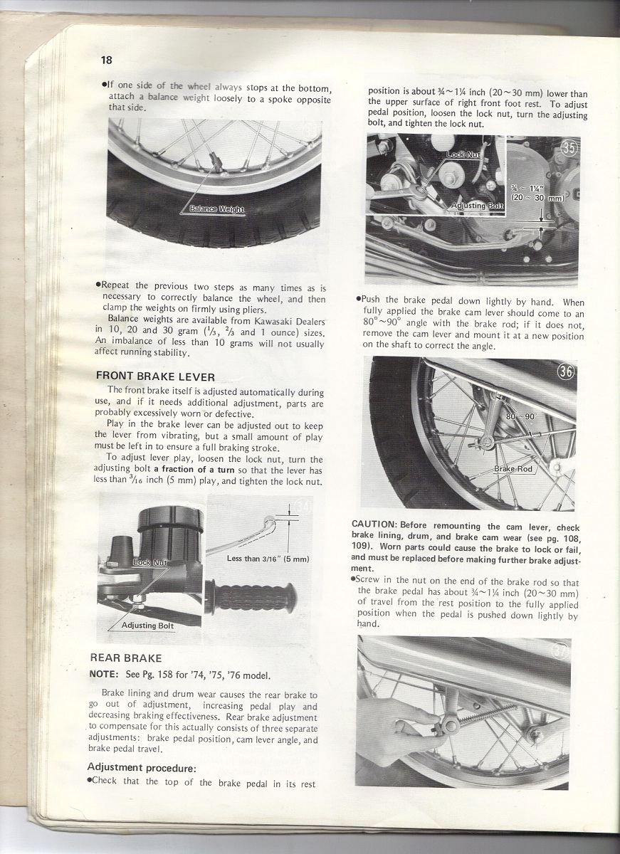

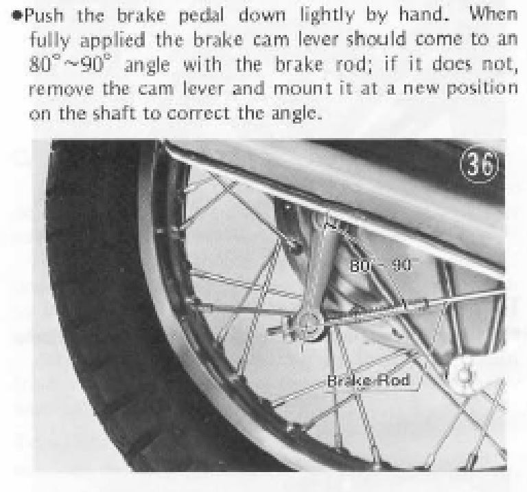

Cam Lever Angle Inspection. The manual probably has a section on adjusting the rear brake. It's probably in the Scheduled Maintenance section... cam lever angle checked w the brake fully applied, most likely, as that's how it's done on my 81 650.

For Z!, info about the brake lever angle is found on pages 18-19 of the FSM in KZr's FILEBASE.
kzrider.com/filebase/search/viewdownload...asaki-service-manual
