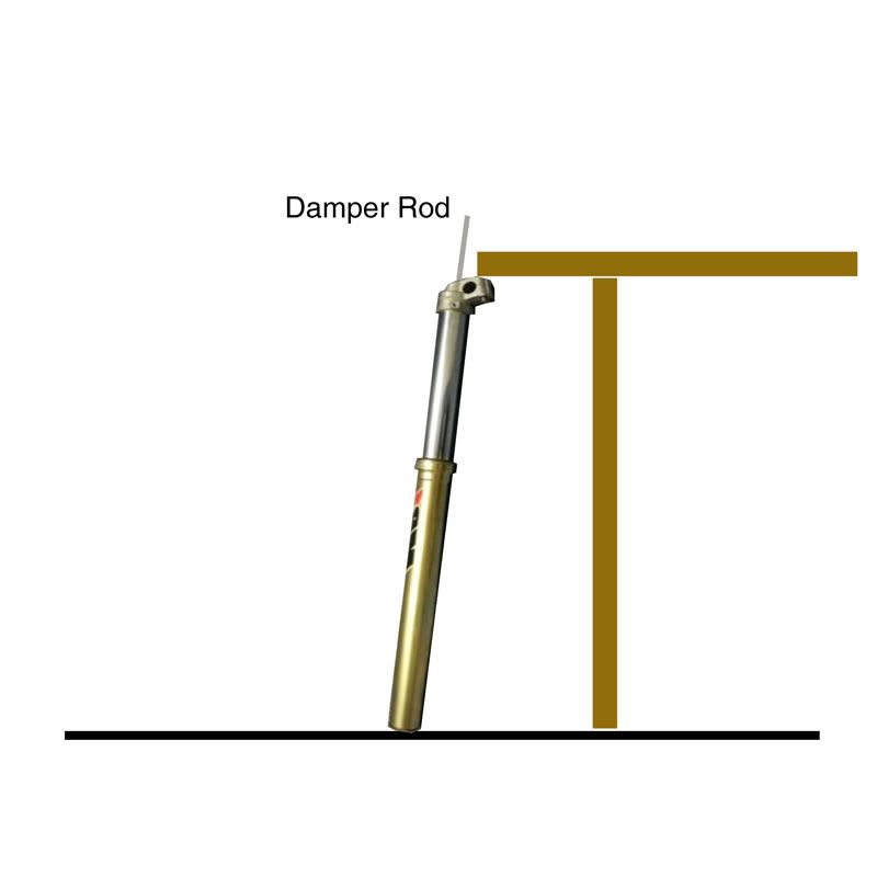

Also, instead of using a broom handle to remove the bottom bolt, just compress the fork a little (push it against the back wall of your work bench) and hit it with the impact. The spring pressure holds the damper rod from turning. This is how I do inverted forks under my bench:
i114.photobucket.com/albums/n248/Jeekinz...0Bike/Fork-Bench.jpg
A trick I use for installing fork seals is to use a clean old seal to tap in the new seal.
What did RT say about machining? Usually they just want you to enlarge the damper rod holes so more fluid affects the emulator.
