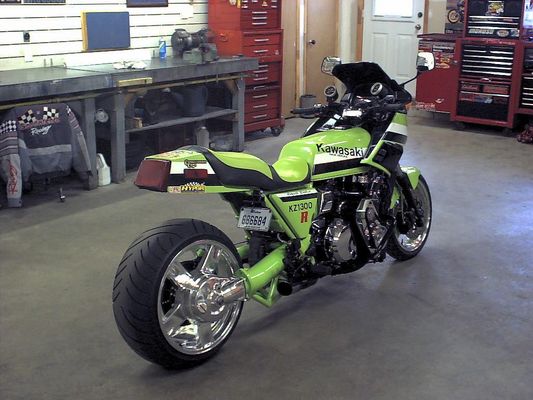

it is a machine and fab job that is quite common on several different shaft drive bikes like the v-maxs,moto-guzzi's and bmw's.
here's a kz1300 that has had some shaft work i bet :evil: :whistle: !

17 Jan 2014 08:42531blackbanshee wrote: it is a machine and fab job that is quite common on several different shaft drive bikes like the v-maxs,moto-guzzi's and bmw's.
Oh, my…. Please tell me this is your bike? Who did the work? How/what was involved?

sorry pic from the net.
watcha see is watcha get :pinch: ,
