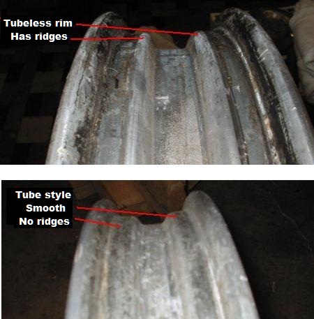

The KZ650-D2 came equipped with tube-type alloy wheels front and rear. Does your front rim actually have the word "TUBELESS" cast into it? If it does not it requires a tube. If it is marked "TUBELESS" someone did swap out the original. Ed

I used to think all tubeless wheels had those ridges, but I recently found a Suzuki GS front wheel imprinted with "tubeless tire applicable" but NO ridges. Very strange.

14 Jan 2014 07:08Strange, indeed.Nessism wrote: I used to think all tubeless wheels had those ridges, but I recently found a Suzuki GS front wheel imprinted with "tubeless tire applicable" but NO ridges. Very strange.
My understanding is that when mounted without a tube on a ridge-less rim, hitting a bump risks dislodging the tire from the rim, resulting in an instant flat.
Not a happy occurrance while leaned over and cooking through a curve. :pinch:

Here's a KZ550-Ltd cast alloy wheel - it's marked tubeless on one of the spokes. You can see that it has small ridges & from memory the 650-CSR tube-type wire spoked wheels have the same ridge profile.

14 Jan 2014 07:51The risk is greater with under-inflated tires (unfortunately, a rather a common condition).martin_csr wrote: You'd think that if a guy hits a bump hard enough to dislodge the tire from the rim, the rider is probably going down in a split second anyway, so it may not matter if a tire deflates??? . . . .
"Dislodge" probably wasn't the best descriptive word -- and doesn't mean that the entire tire escapes or dismounts from the rim.
All that's needed from the bump is creation of a sight passageway for air pressure inside the tire to escape between the bead and rim. Bump - whoosh - flat.
Recovering from hitting the bump, which may be an unexpected and/or unavoidable bump, is already difficult enough without having to also contend with a flat tire.
Especially while heeled over clipping through a corner.
Opinions differ. And some folks persist in mounting tubeless tires without tubes onto tube-style rims, regardless of advice to the contrary (from people way smarter than me). They either don't believe the advice, or choose to accept whatever risk is entailed. Here's hoping they never experience having to learn the hard way.

I wouldn't go tubeless on a tube-type wheel. However, there has been some debate as to whether or not some of the KZ tubeless wheels should in fact have a tube because of the lack of prominent ridges. I think steell has mentioned it.
