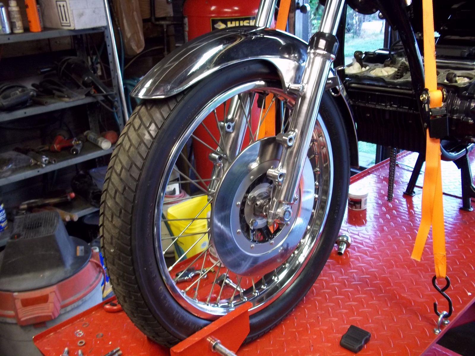

I have done similar. But I always started with a nice disc. no grooves. I used my drill press. Put a 3M ro-loc in the drill press. I had a wheel hub and axle in the machining vise on the flat plate. Mounted the disc on the hub, set the height to jsut grab the disc. With the drill press on. I had rotated the disc in the opposite way as the 3M pad was shining the disc like new.
Thats who I have done mine.
Or you can chuck a hub up in a large lathe.
You can only surface grind 1 side due to the aluminum carrier that is riveted on with a huge press from factory.
I never liked to take a stock disc off of the carrier, I would never be able to get it back on as tight.
I have sold a couple of discs on ebay I cleaned up last year.
Hear is a 76KZ900 That I finished and shipped to "KAZ" in California to export to Japan
But take my flat Harley 10" discs. My machine shop at work had a magnetic plate surface grinder, and it was simple to take a couple of thousands off both sides. I miss work, and the machine shop and parts room.
