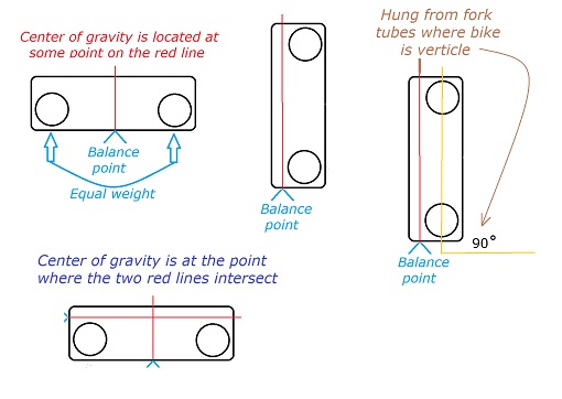

Will float this theory -- which may be seriously flawed -- for locating the center of gravity.
Could use a plum-bob from front axle to rear axle to help attain perpendicular position of the suspended bike.
Other factors also influence the center of gravity by varying weight locations, such as fuel volume, aftermarket components (eg., various exhaust systems, luggage racks), etc.

Weight times arm = moment. So create a reference datum and weigh the front and rear wheels.
That will give you longitudinal CG, I don't have a clue how you would calculate vertical CG.

11 Dec 2013 21:18 - 11 Dec 2013 21:21peavylotus wrote: I found a worksheet PDF that has equations for calculating dynamical and statical load,
You really should just go buy a digital bathroom scale that can report up to 400 lbs. Amazon has them for $15. Then you can work with real numbers.
On the other hand, you could just assume the vertical center of mass was in line with the crankshaft. I broke down a junk yard engine and I was amazed that the crank alone was almost 50 lbs. ~10% of the total bike weight.
