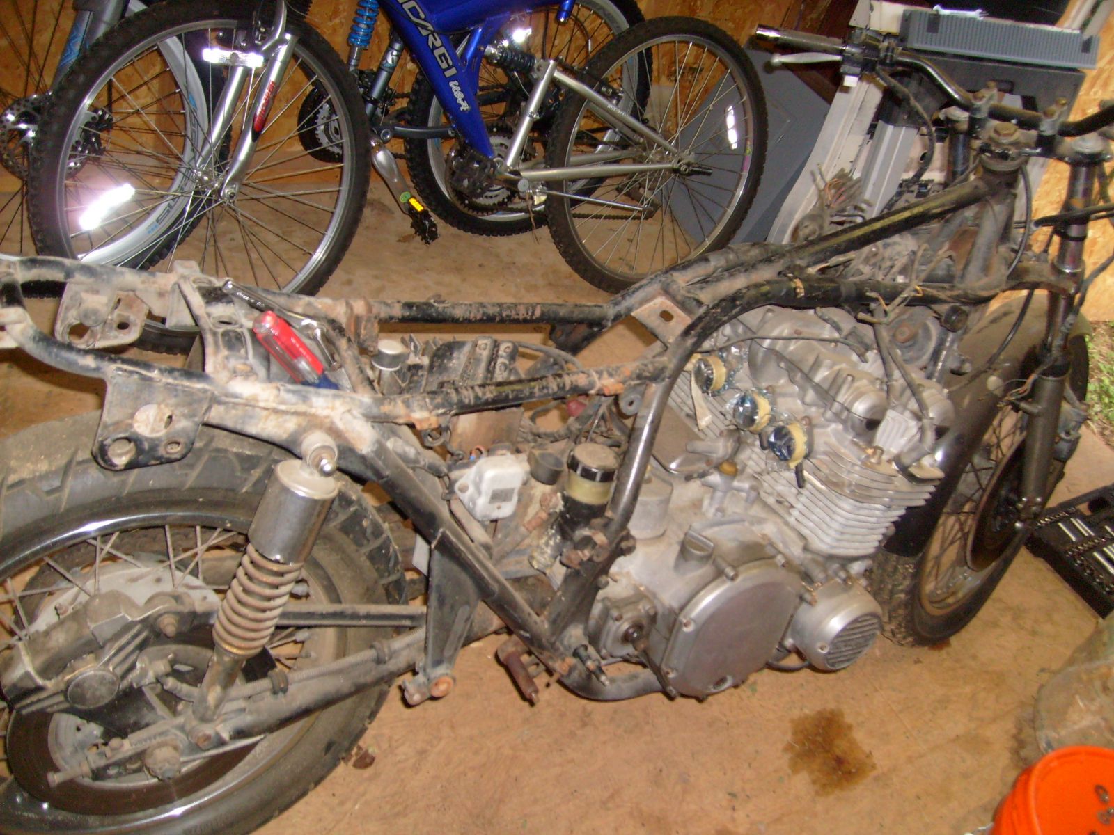

So started on taking apart the donor bike and ran into a locknut on the chain side of the swingarm.
I was ablout to remove the main nut and the bolt but the locknut on the left seems like I need a special socket to remove it.
Any Idea.......tried a flat screw driver and tap it but did not turn.
Donor is a 93 gsxr.
Donor is a 93 gsxr.

Spdygon, try to take an old socket the size of the nut, then grind away material not needed to engage the nut. Mine donor was a "90, yours might be different but it worked for me. Have you done anything with the forks?? I know you asked about ALL BALLS bearing swap.
Just wondered if it worked for you!

Just finish parting the gsxr and started on parting the kz.
As for the forks that was my plan to use the bearing conversion but the lower bearing on the gsxr is rust weld to the stem.
Will try to cut...if not I will have to swap them.
Think I should move this over to the PROJECT FORUM?
