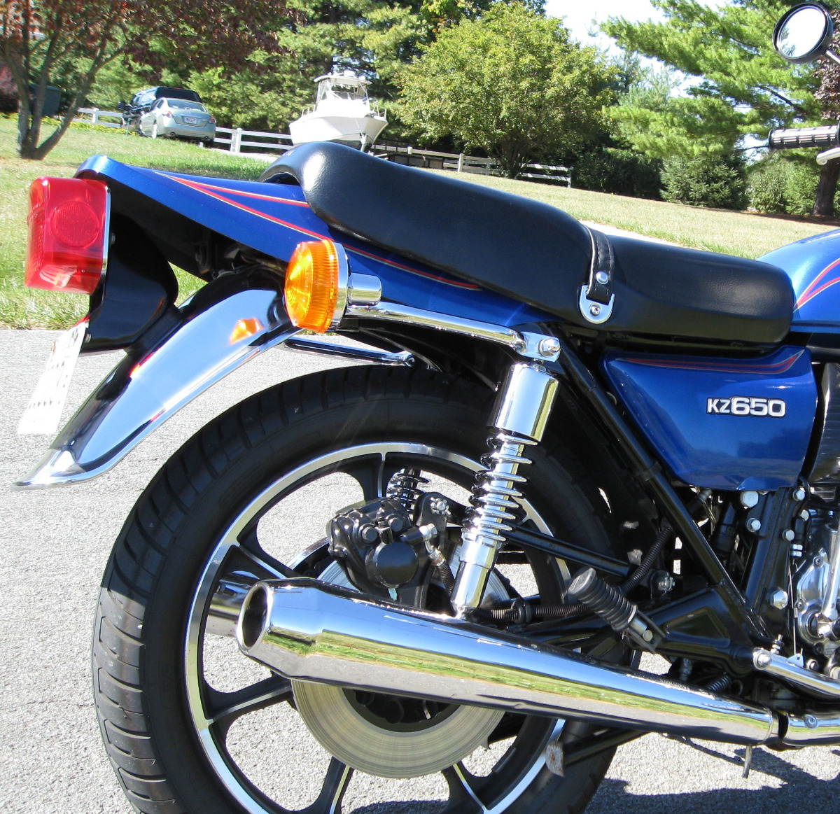

Hagons are more expensive, but they do work very well. I've had them on my bike for 6+ years and they still look and work great. The pic below shows mine on my bike, but Hagon makes a bunch of different styles. Ed
