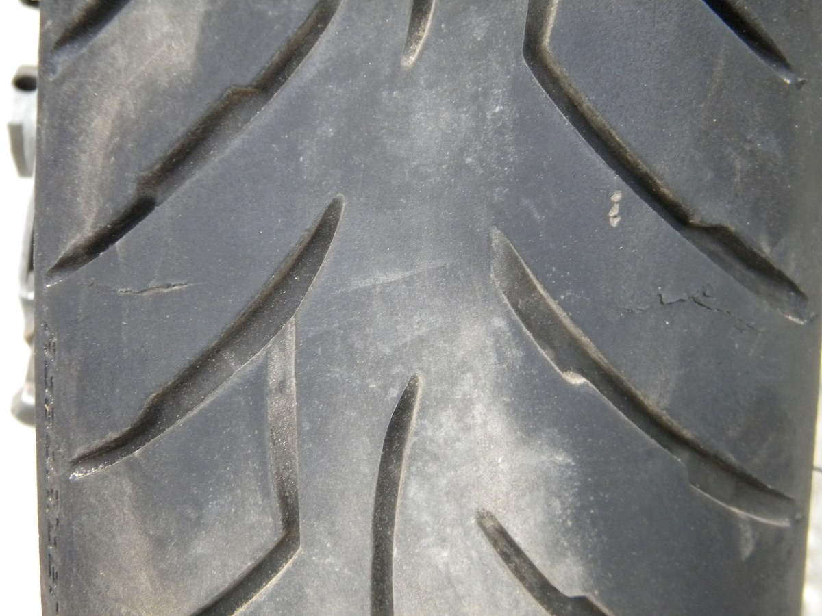

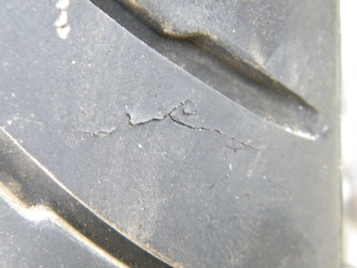

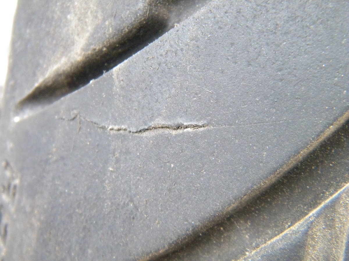

avon north america stood behind a tire I had questions about and they attend vintage bike shows to gather info on their tires/customers in person and answer calls in person....sent me a tire free, no questions asked for a tire that had a separation possible...just asked that I send them the old one at their cost to check for any issue, they said "one in a year of production or so might show issues"

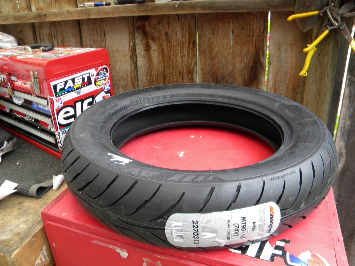

Just ordered a pair of Avon am26 from J&P....Never mounted a motorcycle tire before...wish me luck!
