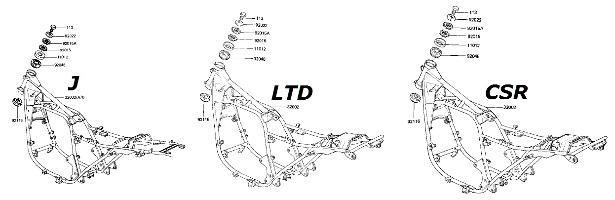

Lots of good info on kawasaki.com, including parts diagrams, part names, part numbers, models sharing same part, availability, etc. Here's a link for help with navigating the site and finding information.
Clickh > kzrider.com/index.php?option=com_kunena&...w&catid=13&id=376734
For example, these diagrams are shown for J model, LTD and CSR:
J model
LTD
CSR
Each of the three frames has a different part number.
J model
LTD
CSR

Patton - Thanks for the link, but the J model is exactly what I was looking at from kawasaki.com. The only difference I see is that in the diagram, there is a raised bracket across the back end (just behind the upper shock mounts), which mine doesn't have.
