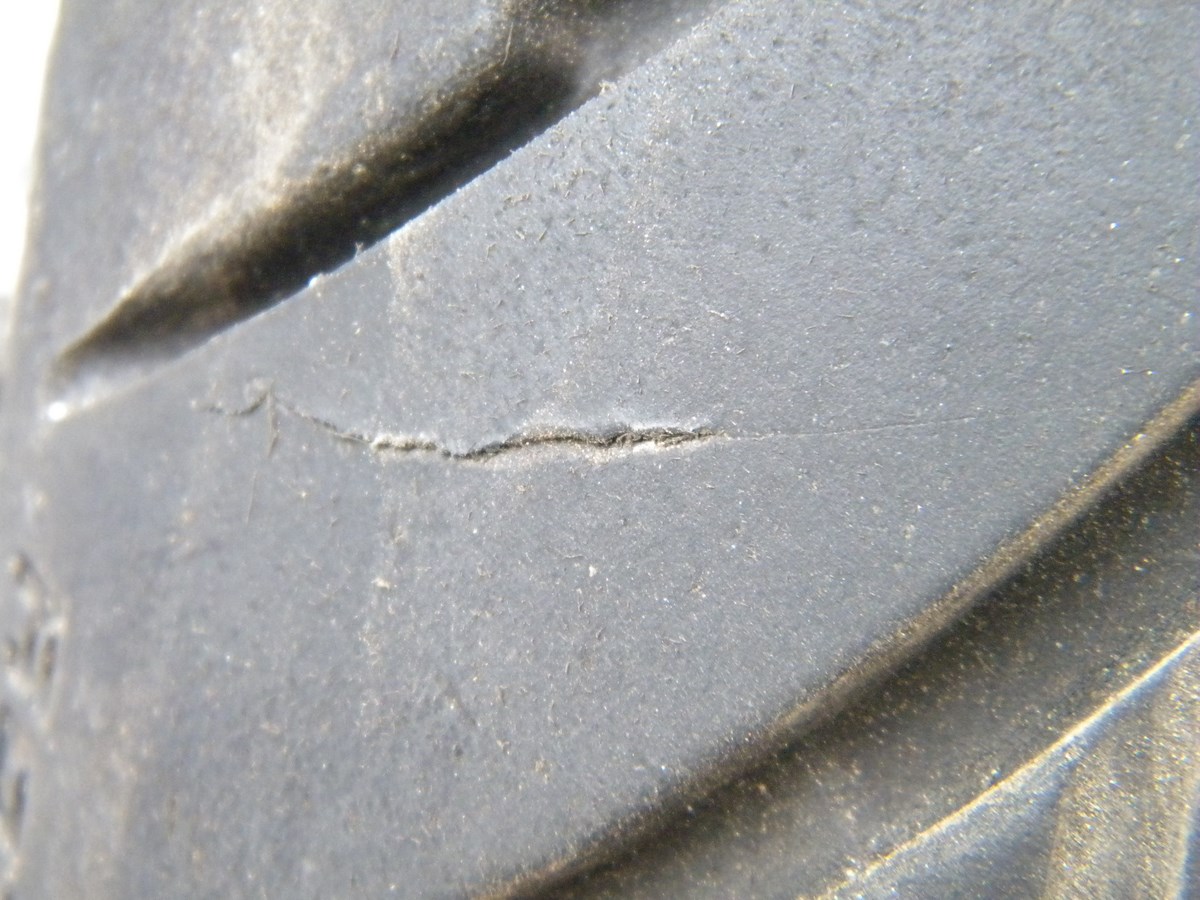

16 Jul 2013 23:27trianglelaguna wrote: I had a small tear on my rear tire ,i noticed it a week or two ago...then saw it again after my last ride...very faint,,,by a tread line on each side of the chicken strips and not on the middle...and called Avon...after some calling around to check where i had bought them (J&P cycles said 120 days)and getting nowhere,Avon north America offered to stand behind the tire..I had put it on last july...and maybe have 3000 miles ...maybe.....this was 6 days or so ago and today the tire is at my door...I may mount it before bike week...I may not...they want me to ship the tire in question back to them (they provide a shipping tag)so they can look at it and have their tech guys find out what made it fail...I am happy with the co. for doing this replacement and asked them if they have had any issues with the roadrider mt/90/16/v...he said once in while you get a weird tire...and they will do a follow up...

before i bought this last set...I had called avon to try and locate a supplier with fresh skins...after reading about born on dates on here...they said J&P cycles moves a ton of tires and would be a good bet........my tires were fresh... there is a code that reads the numerical week and year...mine were installed in 28th-2012 by me... and the date was 33-11 on the tire so close enough...the reason i had called was i had some early for my likes,cracking on the sidewall once before on a rear and wanted the newest rubber i could find...when this last tire had a problem...and J&P said it was out of their service recall range...Avon worked with me.....i may take pics this afternoon when/if i work on the bike....
I was told by a rep for Avon at a race/ride/event to never use tire shine products....he said they can get spun up on the chicken strips....my question was about the cracking to which he just sidestepped and mentioned the spin up....their were folks standing there so i did not press the issue....

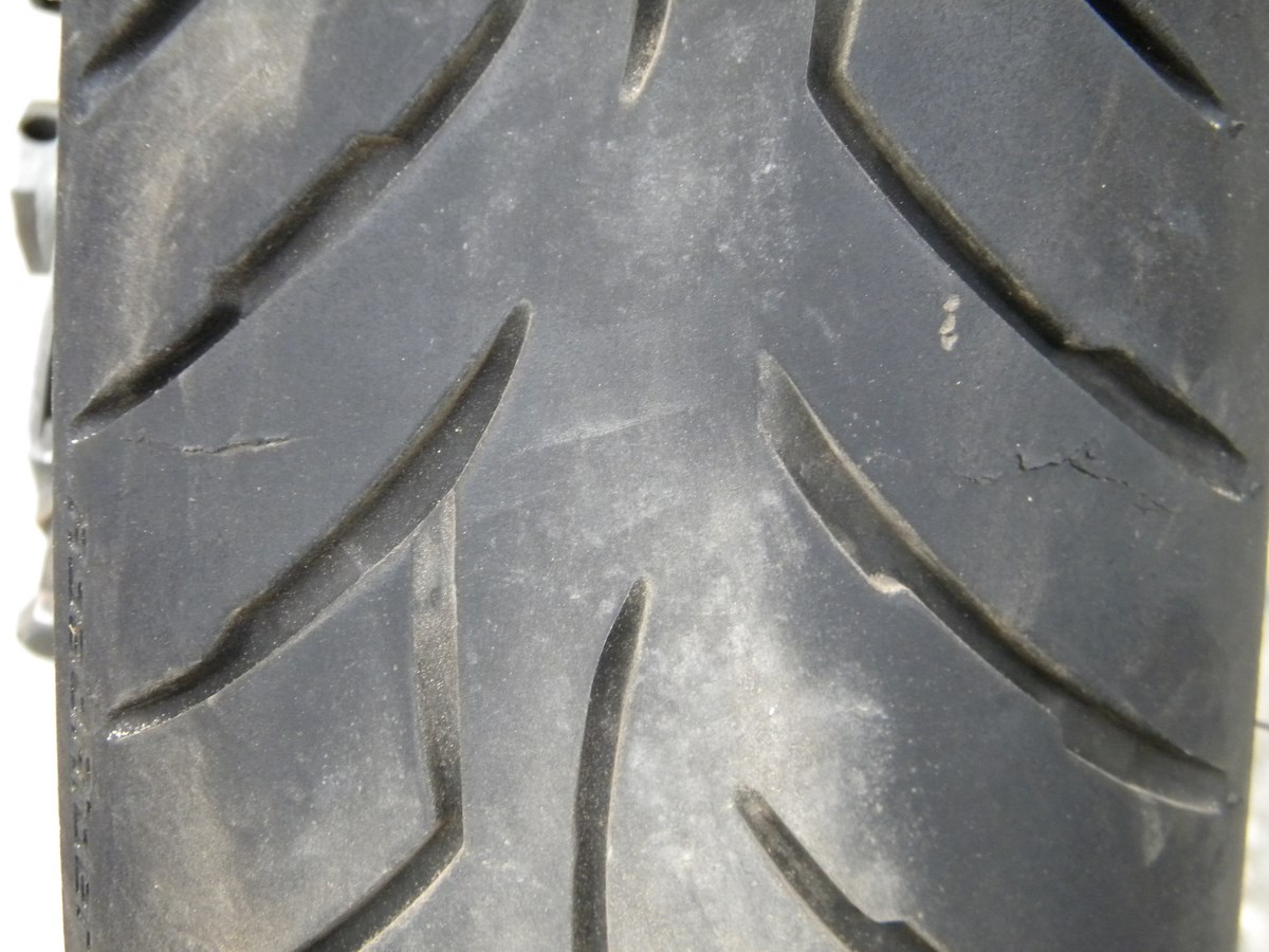

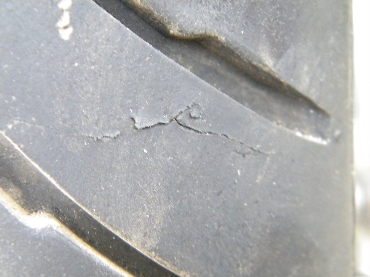

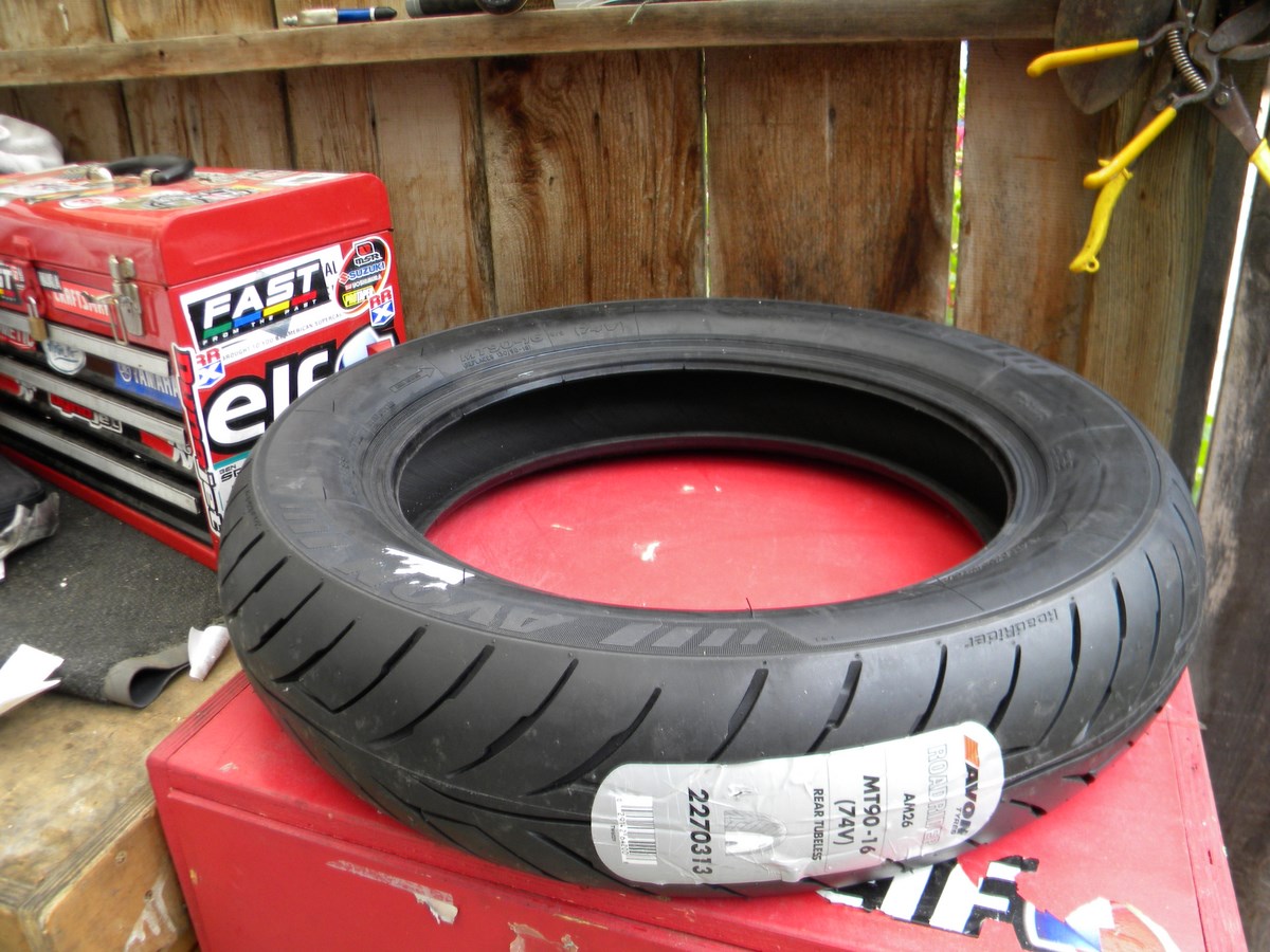

center shot..left side...right side...and new tire they sent me...
I had seen a hairline mark at a stop one day...and then noticed it had appeared on both sides..it worried me so I called to see if they knew of any trouble with the MT/90/16V roadrider...they sent the new one and want the old one to test for flaws...
