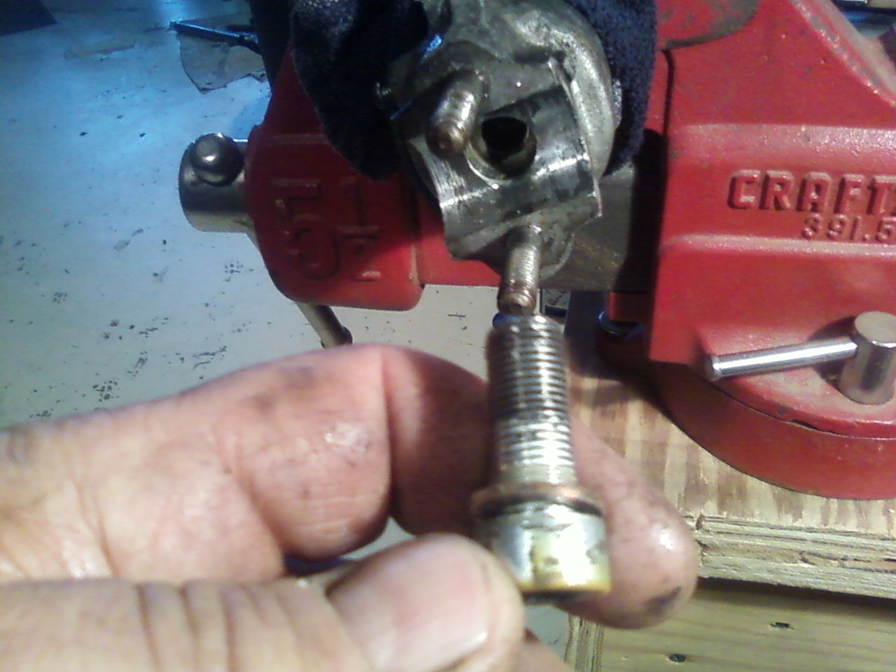

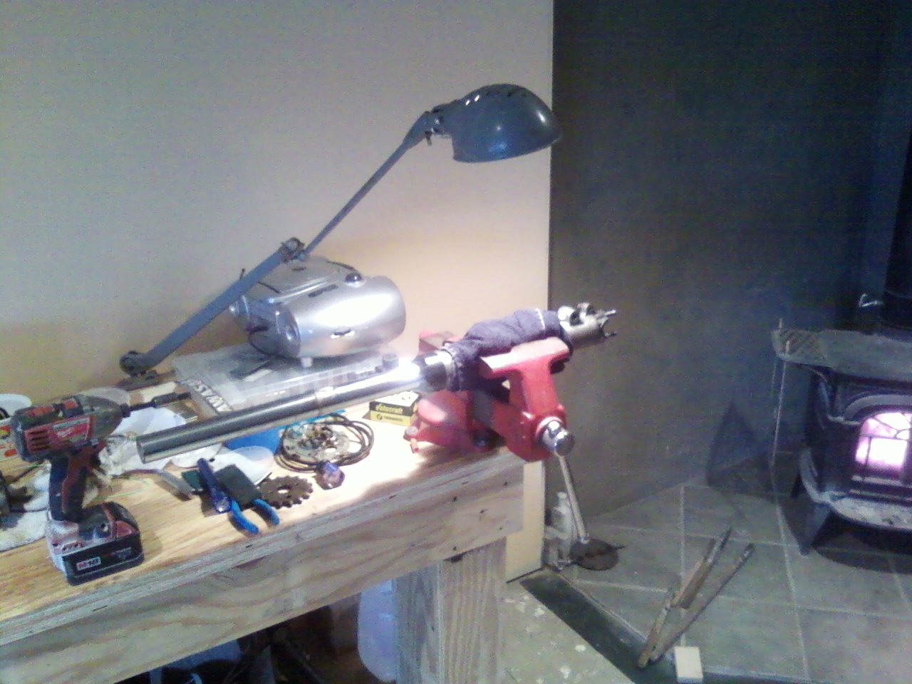

Remove forks and drain the oil by forcing the upper tube down into the outer tube, note; do this in a bucket because the nasty smelling oil will shoot out :sick:
Put the drain screw back in, wrap the lower tube in a protective towel and put it in a vise.

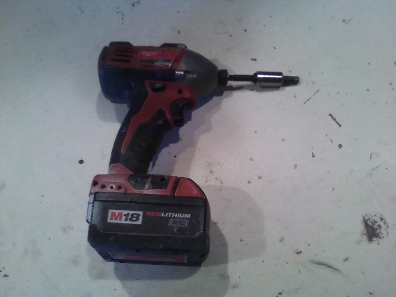

I tried to go straight to the impact driver but the bolt would not budge , I figured that maybe the bolt was locked up with the crush washer and outer tube so I got out the breaker bar and a 2x4 and gave it a few whacks until the bolt started to turn.
Then I went back to the impact driver and found that the bolt was spinning but not coming out , so I grabbed the upper tube and compressed it into the outer tube to create more pressure and tried again.
This time it worked
Both nuts are off, but I am going to wait until my son gets back into town before we replace the seals and dust covers, don't have them yet anyways.

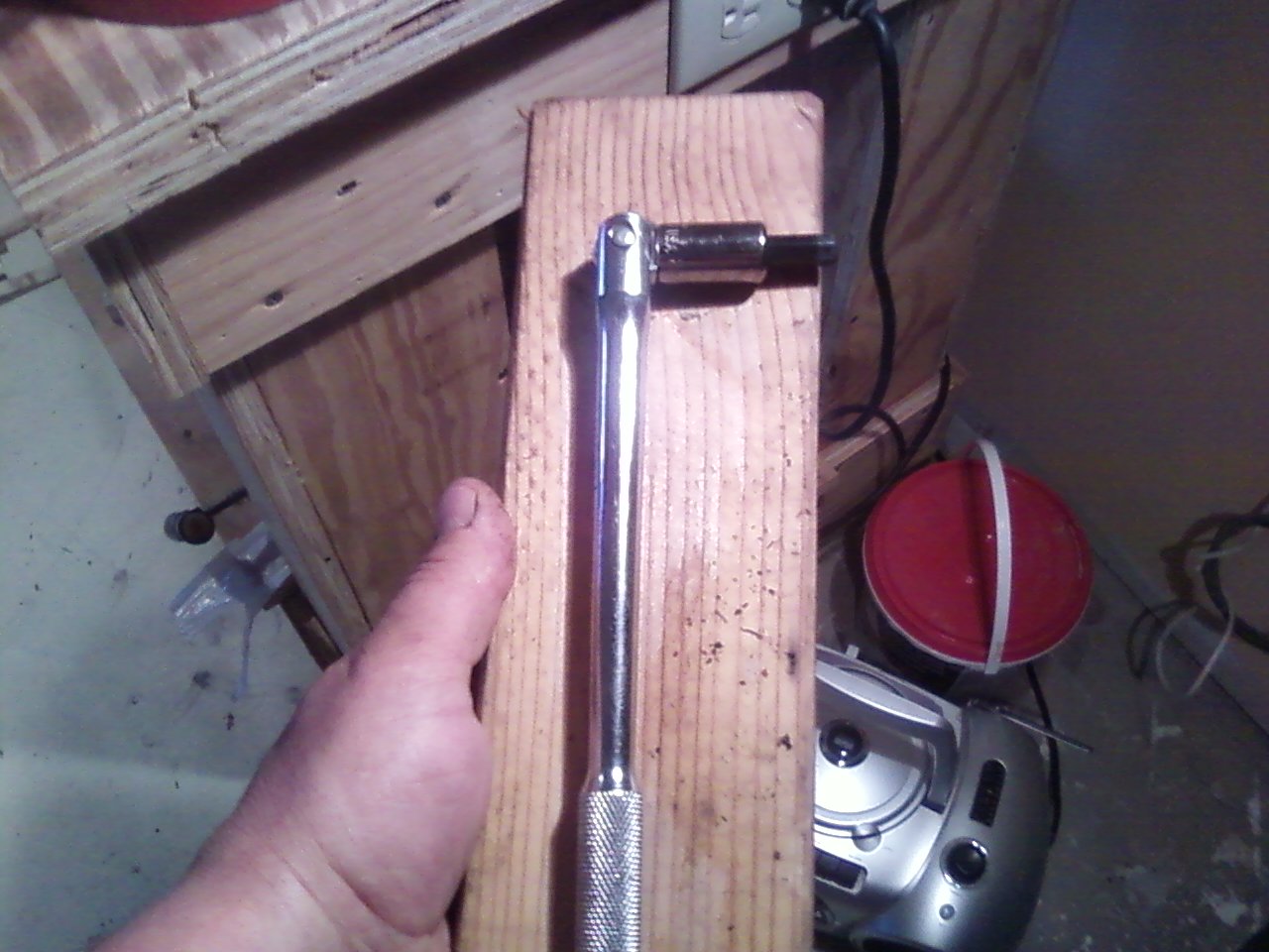

I used the factory tool on a set of forks 30 plus years ago because we didn't have access to a compressor to help my dad tear apart a front end.
He actually slotted the top of the dampner rods and did the reverse on a socket so he wouldn't have to borrow the tool from somebody again.
With his set up you could just put that socket on couple really long extensions with a ratchet and use it to hold the dampner while you removed or installed the bolts.

I bought a 1/2" impact tool last year for working on the 1000 but it is still in the box.
I'm afraid of snapping old bolts.
So far my cordless Impact is doing the trick with the smaller stuff.
It is also real good for taking out the original never taken out before JIS screws using a modified Philips bit, just tap the trigger and they pop right out.
