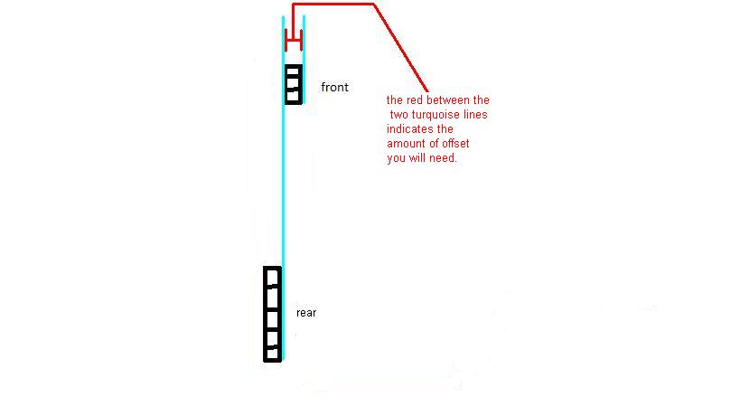

Gets worse.. man this offset issue really has me computing..
520= 5.8mm
525= 7.05
530= 8.74
630= 9.5 (estimated)
That is with me measuring sprockets in stock which they are vortex sprockets.
Taken from the DID website, a 520 VM2 X-ring chain has a 22.95mm outside pin width, while their 520 VT2 X-ring chain is only 18.70mm.
Divide that 520 chain /2 thats 9.5mm, 18-9.5=8.5
the difference of the 520 rear 3.mm that would put me at 114mm .
Minus the 8.5 I can allow before tire rub that would put me at 105.5
105.5 - 85 = 20.5 = 51/64"
4mm over 5/8ths..Doh!
BUT since the 520 chain is thinner I can run 3mm closer to the frame than the 5/8s 530 offset sprocket so if I go with a 19mm offset 520 sprocket I will be 1mm of true which is good enough because I have done some rounding as well.
Leon where are you???I need a 19mm offset 520 sprocket! :whistle:
Zed I might be second guessing the math. I got a good strait edge today and it got me 25.5mm or 15/16 offset front. *Edit the lazer was around 7/8 to 29/32.
