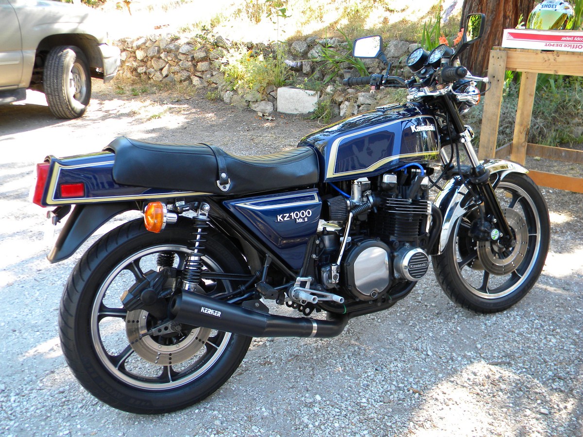

Man that there was one sweet ass ride if I do say so myself. You really got rid of it? Like Elvis?
