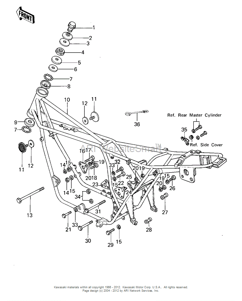

If thats a 78 A@, then the parts show a bracket there at the rear master, #35, for the 1 mounting point. But I don't see others, and the side cover has three tabs that would go into grommets.
You can see some of the tabs that would be part of the frame, above 32 & 33, maybe?

I agree, looks like on the left just below 20 is another. Previous owner mst ave shaved them off for his own reasons. Lol life can't be perfect. I was thinking of visiting some isles at lowes with a creative mind. I'm sure I'll figure something out that looks pretty decent...
Thanks for the diagram Motor Head!

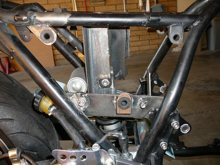

78 definitely had tabs... AT least my 78 frame does...
Welded tabs is the way to go no doubt.... but 1/8" plate x 1.5" wide curved and clamped to the frame in position would work just fine...
Maybe this will give you some ideas on the bottom tab...
