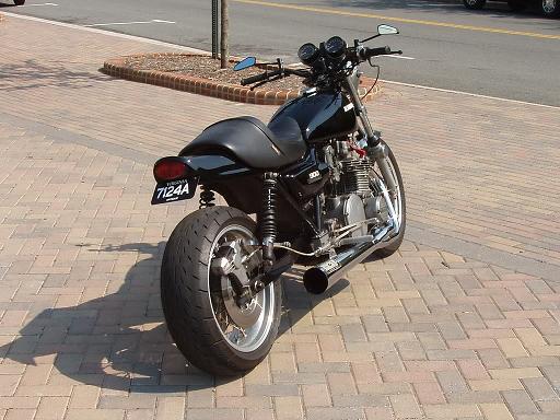

190 Street Shootout Tire, Radial Tubed since 1998.
