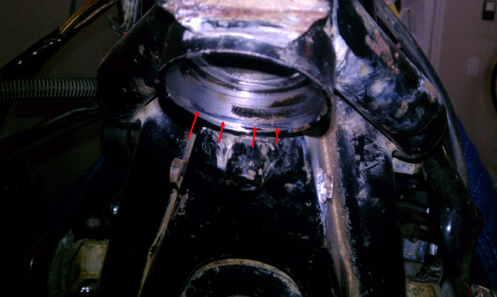

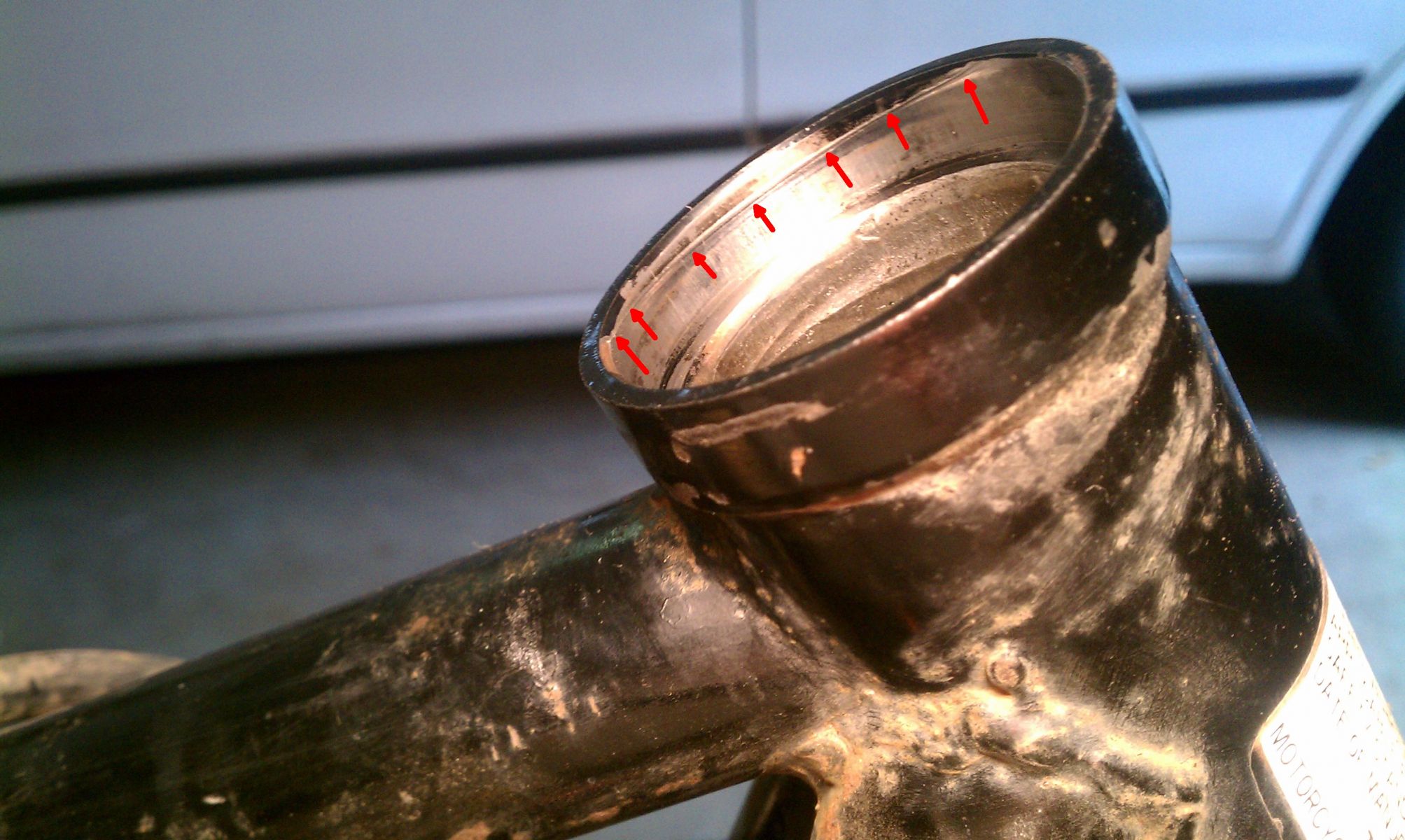

I am in the process of replacing my head stem bearings with new tapered bearings. First time I have done so on any bike. So I did my homework and read from the file base here and read two service manuals to be sure I know what I'm doing. However, when taking the racers out, it seems like I may have damaged the head stem bore a tad as you can see from the pictures below (look for the red arrows).
Top of stem:
Bottom of stem:
As I was tapping the racers out, I tried to do so evenly tapping on opposing sides. But one side kept moving out faster than the other. Same thing happened with both top and bottom racers. So this is what caused the burring in the bore where the racers sat. Seems like this operation should have been easier and I heeded the warnings from the manual about making sure to tap evenly around. But no luck.
So my question is, has anybody came across this issue? And what did you do prior to installing the new bearing shells to replace the racers? Did you just sand the burrs down? Just would like to minimize the problem and not cause anymore harm.

I would just sand, grind, or file down the raised edge so it doesn't interfere with installing the new races. Just don't remove more material than is necessary. I don't believe the new races will be affected by the slight irregularities because the damage doesn't extend all the way to the bottom of the seat. Ed

Hi Joe, you can also grind the circumference of the old races, and use them to finish driving the new ones in. This protects them from damage from a drift punch or what ever you use. Bob

18 Jan 2012 17:12650ed wrote: I would just sand, grind, or file down the raised edge so it doesn't interfere with installing the new races. Just don't remove more material than is necessary. I don't believe the new races will be affected by the slight irregularities because the damage doesn't extend all the way to the bottom of the seat. Ed
ed is right on here joe.
had the same thing happen on my z1r and i dressed them down installed the new ones and didn't give it a second thought.

Ed, Leon, thanks for the advise. Gives me a better feeling going forward. Will proceed with your suggestions. Thanks Bob for the tip. In the back of my mind at work today, I was trying to figure out what would be the best thing to use to drive them in. Didn't think about the old racers. That is an excellent suggestion.
