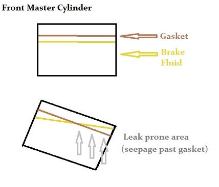

Z1E lists several handlebar styles:
Click > www.z1enterprises.com/searchresult.aspx?...e&KeyWords=handlebar
Many riders enjoy the "superbike" style aftermarket handlebar.
When replacing a pull-back style with a lower bar, it's often necessary to replace the master cylinder, brake line, throttle cables and clutch cable.
Sometimes the master cylinder may be slanted off-vertical, but not recommended imo.

The previous owner has put some semi-western style bars on and everything's all squeezed on there. They are comfortable, but due to the cramped position of the indicators that hit the tank when you're turning tightly (not even full lock),they have to go. The cables are also too long and have alot of slack. The brake master cylinder is also on an incorrect angle as shown!

Assuming it's exactly the same handlebar setup as on a 1000 LTD, I'd love to know exactly what mods you made to get these bars to fit - they are exactly what I'm after. I'm sure there's a lot of people who would love to change from the bloody "apehangers", but aren't sure what's involved.
I can tell you for a start that the cables are too long, the indicators hit the tank if mounted on flatter bars, and the stock Master Cylinder sits at an absurd angle. That's my experience anyway.
