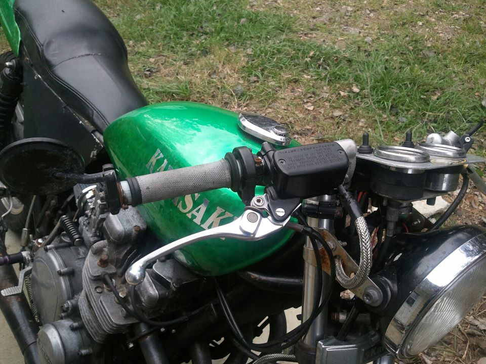

well i screwed up and didnt check my master cylinder clearance for the new drag bars i got and now the master cylinder is clear in my way. i was wondering if anyone on here has gotten an aftermarket master cylinder set up off another bike that is substantially smaller. or if anyone has run into the same problem as me and how you fixed it.

I got this one from ebay I think i got it for about 50.00 it's the same one for multiple bikes the one listed for a kz1000 runs about about 79.00 they have them listed for other models that are alot cheaper.(it's the same part) and I love it piece of cake to install and work great

31 Dec 2011 10:21 - 31 Dec 2011 10:22I run a master cylinder off of a Honda CBR 600 F4i and it works great. I have clip ons instead of drag bars though.

I picked up a Brembo radial MC to shave some room. The trick was finding one that worked for a single disc set-up AND wouldn't break the bank.
