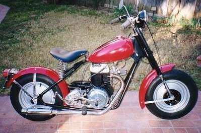

13 Oct 2011 10:06650ed wrote:Attachment Tractorwheel.jpg not found
Attachment tractor.jpg not found
:laugh: :laugh: :laugh: :laugh:

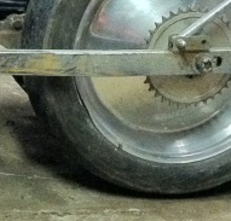

13 Oct 2011 10:15Looking like they are not 2 piece rims. With a Kosman hub that used 8 holes for sprocket and 4 for disc.hal0tw0 wrote: So I finally got the wheels and my friend is letting my "borrow" them to mock up on my bike. Im excited the more I look at them. They make the bike look "chunkier" if that makes any sense...Im kinda diggin it just by standing the parts next to the bike.
The swingarm is boxed steel, chromed, and appears to measure out stock length wise, it has a 140 tire on it but I might be able to fit a 150/160.
I could work out a barter for them so I may just keep them
I can honestly say Ive never seen a set like this in person and I think it works cause its period correct in a way.
Let me know your opinions....good or bad
They do have street tires on them!!!
The CCI rims with Kosman hubs were for drag slicks. We used to call them tinfoil rims.
Very thin, had to mount slicks very carefully.
They look street worthy. Imagine all polished fresh and shiny.
I would use them.
I would like them :evil: :woohoo:

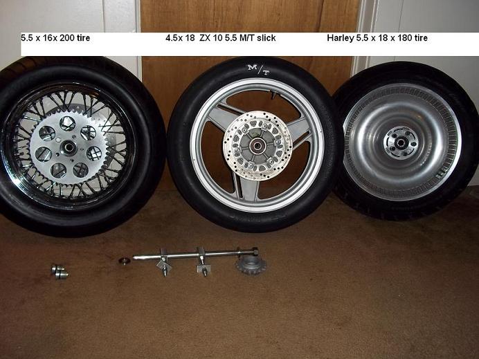

I am working with these on 2 different projects.
It is all for sale! One sale!
Attachment als.JPG not found

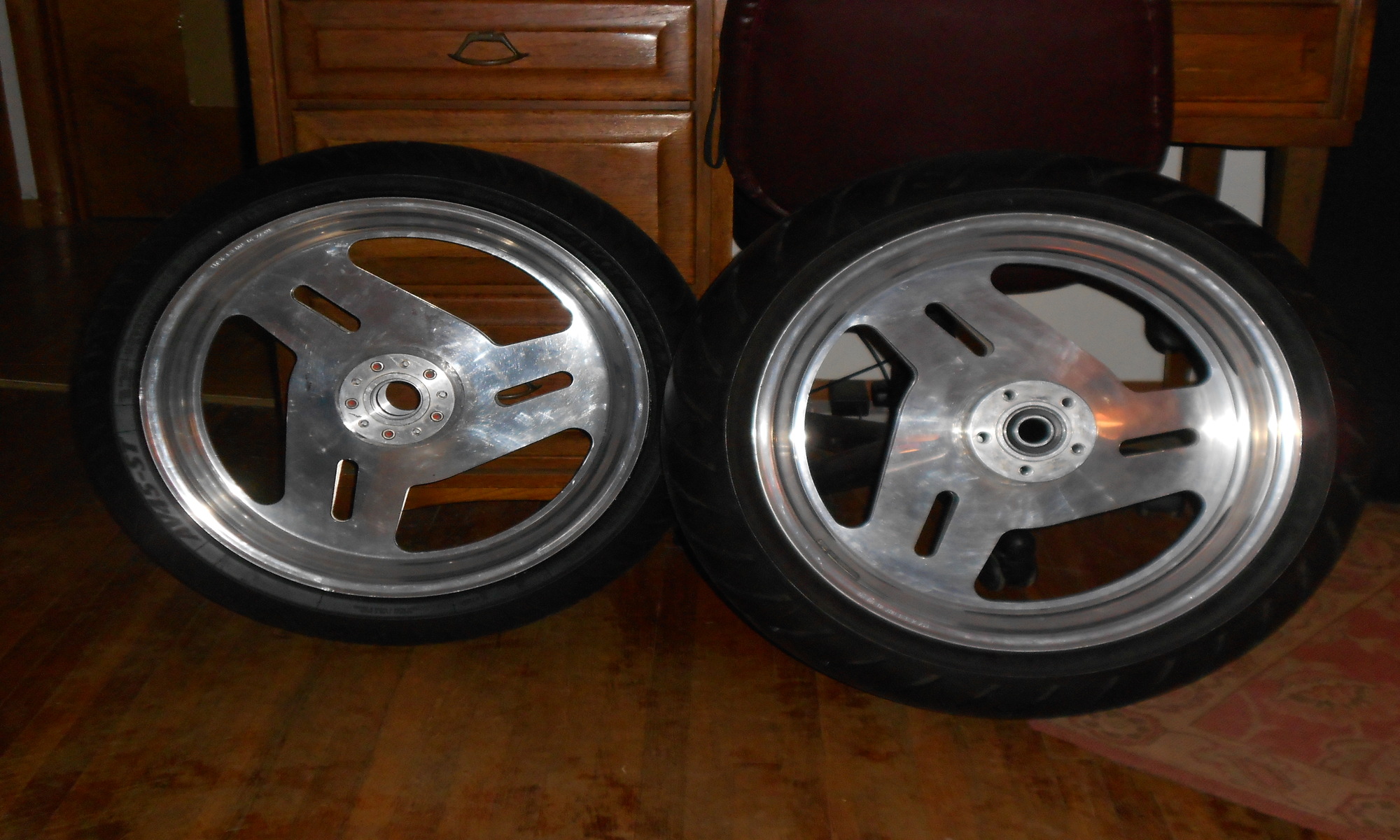

i have a buddy with a fat boy that has solid rims.
he says he doesn't notice side winds pushing him around.
i also have a friend that has an ultra classic (h-d bagger) that has fat boy wheels and he would not keep up on a ride.when we stopped he said he thought he was getting a flat because his bike was moving around so much.no flat but it was windy.
i recently bought these wheels for the blue z1r they are pm wheels,they are pretty thick tho.
they are spun out (kinda like a dish pan)then fit together and welded down the inside where the spokes normally go.

Leon,that's exactly how PM manufactured wheels- they originally bought spun aluminum blanks from Mitchell, welded them together and added disc or sprocket carriers. They started doing cutout machining to reduce weight when the wheels became popular for dragracing and also as they had the cnc machines to do it. Some wheels are fine for street use, some like the ultra lites are not. A very good friend of mine was the shop manager at PM for years and years...

13 Oct 2011 13:52Am I the only person who thinks that rear wheel has a bent rim? Look at the rim, right below the swingarm. Could just be the picture, but looks bent to me.

Good catch! It should be easy to fix though.
