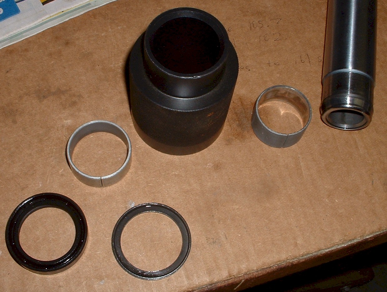

Here's the dimensions for the lower, just in case anyone wants to know:
O.D. 36.92mm ~ 36.95mm, nominal 37mm?
I.D. 33.92mm ~ 33.95mm, nominal 34mm?
Thickness 1.47mm ~ 1.49mm, nominal 1.5mm?
Height 19.70mm ~ 19.75mm.
The cut is approx .70mm wide.
Here's the other parts and seal driver.
You can see the upper bushing, (near the left side of the photo), is lighter in color than the lower.
I was hoping it was like wheel bearings, where they are just some industry standard bearings. It would be nice to find a cheap source of standard bushings if possible. Is there any chance that lower bushing is coated with lead? It seems too dark to be zinc. Do they even use zinc as a coating? The uppers look to be zinc color, but mettalurgy is beyond me.
Retail on the upper bushings is like $25 now. WTF? They used to be like $4 just a couple years ago.
The upper bushings do have some markings, but the lowers have nothing. Both are steel with copper plate, and some other coating on top of that.

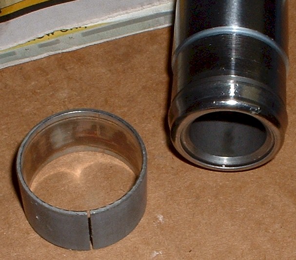

Those look perfectly fine. If I would worry about bushings, I would worry about the top ones first. They can wipe out a set of seals real fast if they are bad.

Yes, that one looks ok, but I think it may be wearing thin. The copper is starting to show through the gray coating in spots.
I always replace the upper bushing when I do the seals, but the lowers have obviously never been replaced. I'm noticing a little more play on some of the forks versus others in the bottom end. (I have like 6 sets of forks, but some are bent or pitted beyond repair. Naturally, the pitted ones are straight, and the bent ones are clean.) Some will have a little wiggle room, but some have a lot and they click audibly when I apply side force, with no oil, of course.
