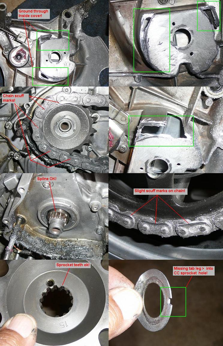

Have to agree with all replied no doubt...
One more variable to add... Depends on you, the rider...
Translation, just cruising, normal accelerations through the gears or winding her up, twisting her hard, high rpm downshifting for increased breaking etc....
All comes into the equations of how long your sprockets/chain is going to last...
Same time, 630 O-ring chain, wholly crap that is one tough sonsabitch..... :blink: :woohoo:
Cleaned the chain of all metal particles, re-lubed, still use it with 0% issues... Damn thing didn't even stretch....
CC sprocket fell off while riding... Cut through casing like a Chain-Saw through butter....:pinch:
