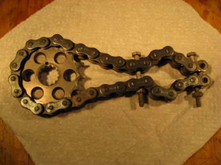

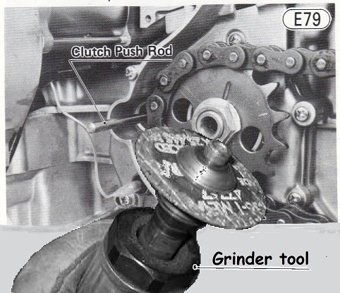

May need a more powerful air hammer (impact wrench).
Here's one method for holding the sprocket in position:
As already mentioned, must be careful not to damage the spline draft shaft.
Would not allow grinder wheel to touch the spline drive shaft.
Enough surgery on the nut should allow final removal with a chisel, all without ever touching the splines.
If must resort to grinding, instead of the larger grinder pictured above, would elect to use Dremmel tool (likely consume several cutting wheels) and proceed very slowly. Being smaller and less aggressive, the Dremmel tool is imo more precise and easier to control
Wear eye protection.
