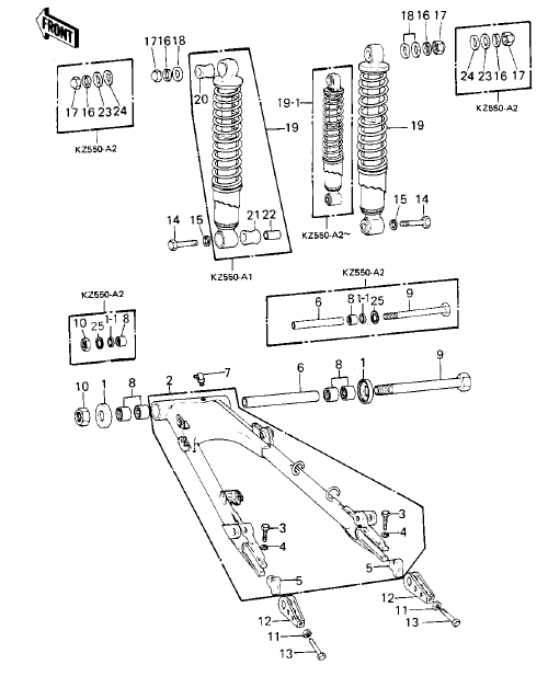

I have been going through my '81 KZ550 trying to get it ready for the spring. Today I went to remove the swing arm to clean and to be able to replace the chain. For the life of me I can't get the swing arm nut off. I was pushing for all I was worth on a breaker bar on the nut and it will move maybe an inch in either direction. Is there something I'm missing?

Patton, I wish there was a grease fitting. For some reason Kawasaki discontinued the fittings in 1980 for the swing arm on this bike. The remaining few years, you have to disassemble to repack the bearings.
I have checked the swing arm for lateral play and I don't see any. Up and down motion is smooth with no resistance so I am going to hold off on this project. It looks to me like the nut has welded itself to the swing arm bold sleve, as the whole unit will turn when I put a lot of pressure on it. This repair will have to wait until I either pick up an impact wrench or a torch for my shop.
