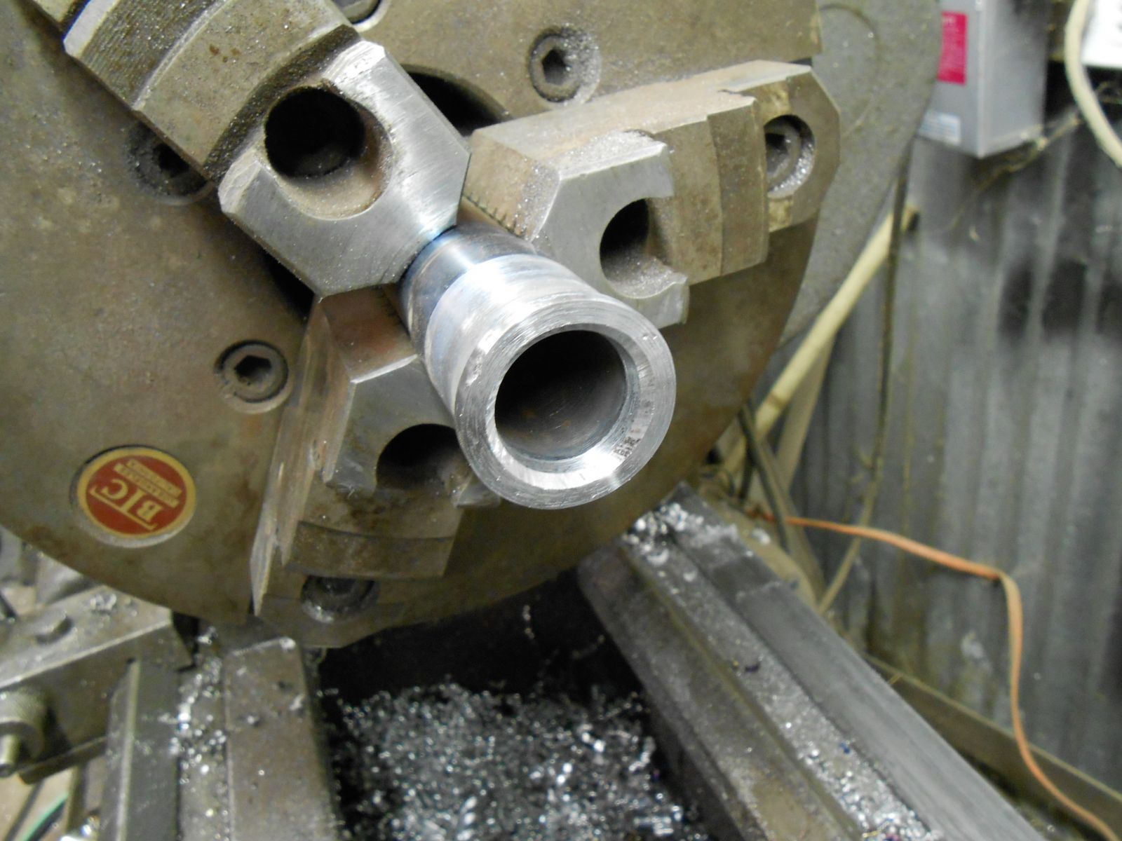

Leon a quick question. After trying to shortcut and go the ALL BAlLs route I realized the stem ( GSXR 1100 ) is not quite long enough in my opinion. I have the old stem removed from my KZ tree and sleeve turned for the bottom triple..........my question is how do you weld the two together?? On the outside and then turn it down to size??
Your last post said weld on the inside!!?? My stem only has roughly 1/2 I.D and I'm unable to get my tig torch anywhere close........even with the smallest cup. Suggestions??
- Posts: 7444
Re: Triple tree custom work
17 Dec 2013 06:25
got any pics of your stem and sleeve?
- homert1
- Posts: 55
- Thanks: 6
- Posts: 7444
17 Dec 2013 06:39
no problem.
i usually try to weld the end .
when i machine the stem and machine the sleeve i try to leave a bevel on each so when pressed together they leave a groove i can make sure i get adequate penetration so i can machine the weld down smooth with no worry of the weld failing.
hth,
hth,
