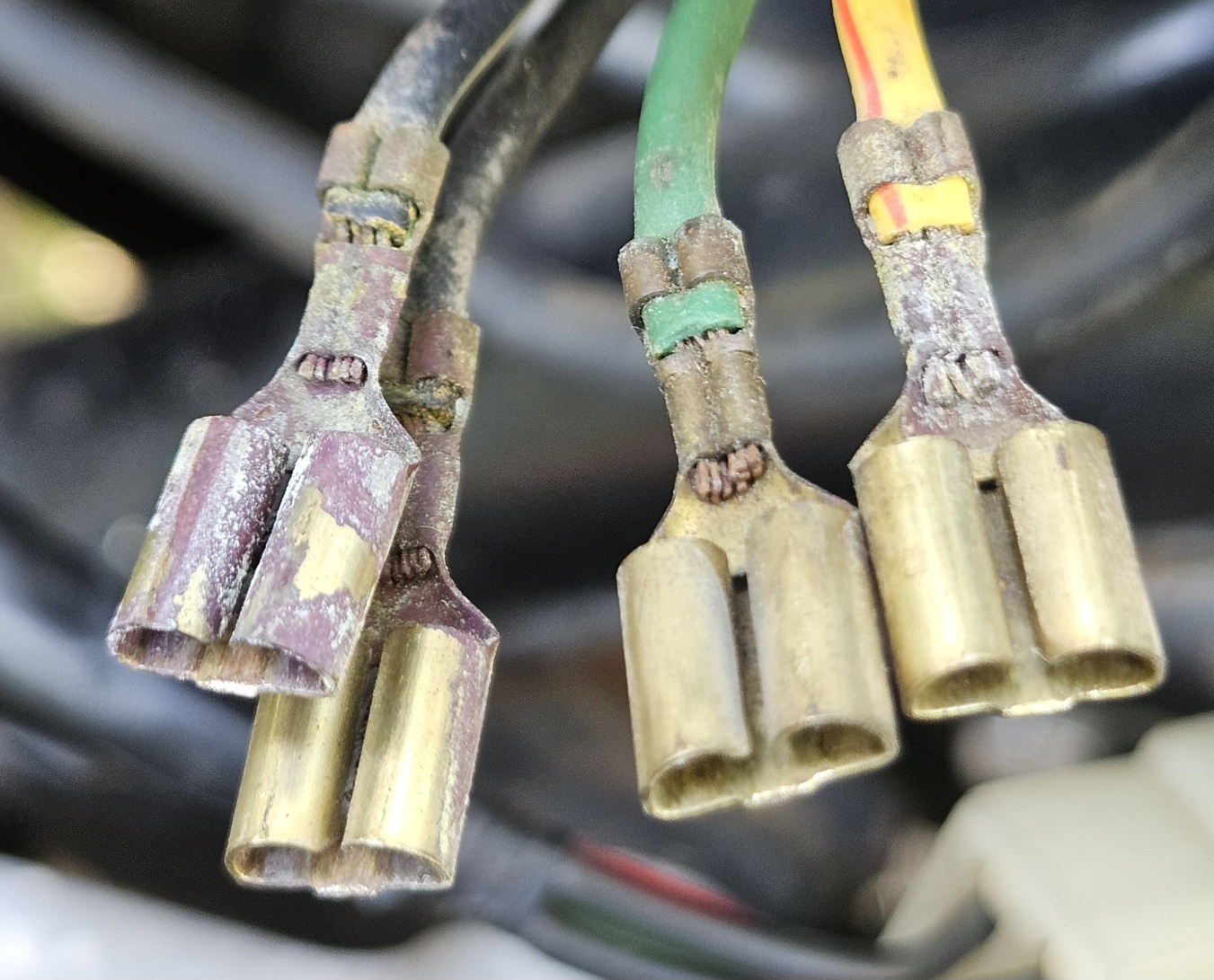

If you can source replacement terminals I would cut them back and then seal the cables with solder before crimping on the replacements. The wires look corroded inside the crimp

Yes i have replacement terminals that I used. One issue is that when I was cutting back the wires to get to clean copper I just kept cutting and cutting. There was some green in the center and some red on the outside of the windings. I was eventually getting to cutting the wires too short so I just crimped on the terminals and called it. These were the wires going into the igniter... I cant imagine what the wires on the rest of the bike look like.
