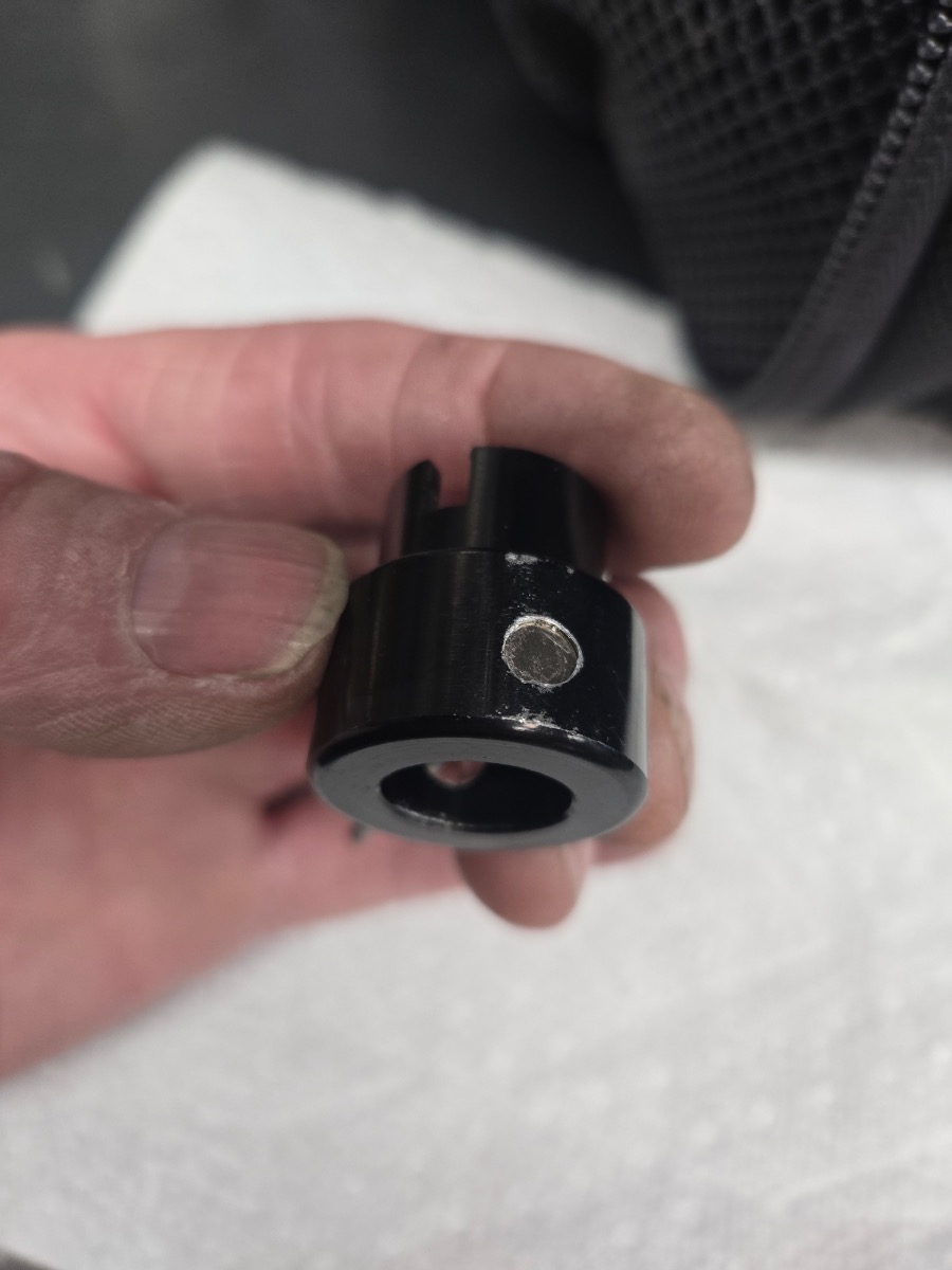

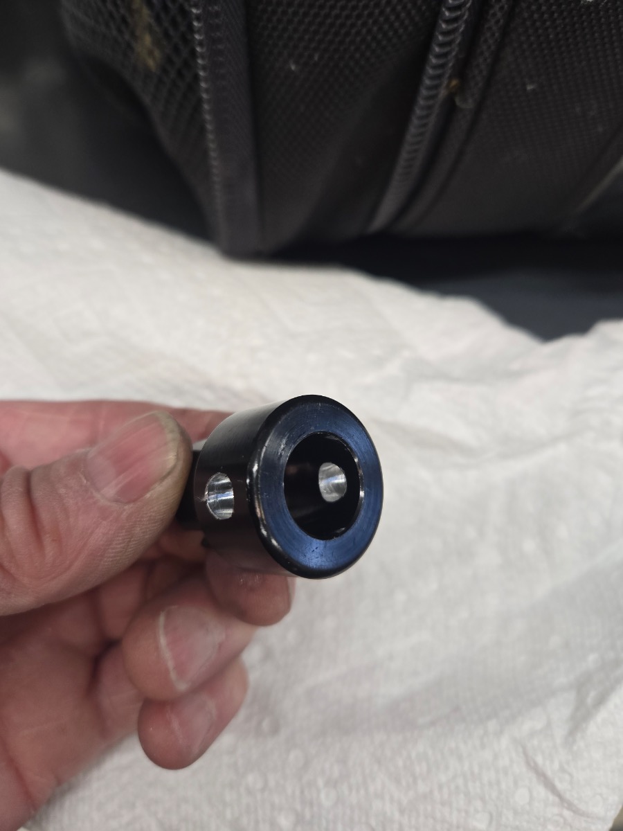

Recently I have had a few of the units (on a bike I sold) shed their magnet in the middle of a ride. Not good. You may expect it from the China knockoffs but DynaS? Well we replaced the cheap China unit after it lost its magnet and replaced it with a Dyna S thinking that spending the additional $140 dollars would solve the problem! WRONG! The Dyna S lost its magnet within 40 miles. Those magnets are just set in a pocket with some epoxy over the top. So I thought about it and decided there is a better way. So I drilled a pilot hole 180 degrees from the magnet and to the bottom of the magnet. I used a Dremel to remove the epoxy on top of the magnet and tapped out the magnet. From there I used a slightly smaller drill than the diameter of the magnet and drilled both sides. Then I used a drill the same size as the magnet and drilled through the original side where the magnet sat and to the other side stopping just short of the outside diameter. This created a lip that will hold the magnet in place once inserted. I filled the remainder of the holes with epoxy (original JB weld, 500 degrees). With a lip of a few thousands and epoxy behind it there is no way that will come out. So I will be doing this to all of the bikes with a China knockoff and maybe the ones with an original Dyna S. I have several bikes running the china units and several with original Dyna units but none of those magnets have spun off but do I want to take a chance. Anyway if you have a China unit you may want to think about doing this. Here are a few photo with the holes drilled and the magnet inserted before epoxy.

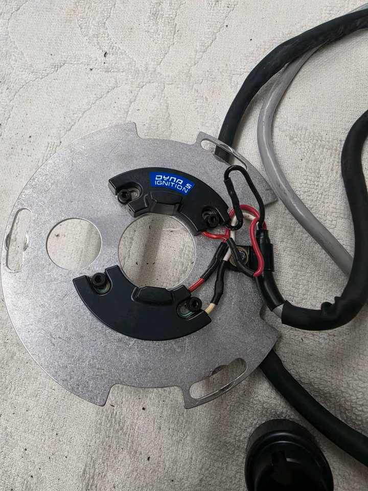

I’m really curious to see how this turns out: I bought a used Dyna S ignition system today. It was pretty cheap (obviously—otherwise I wouldn't have taken the risk), so let's see what to expect and whether it actually works
I'll keep you posted!

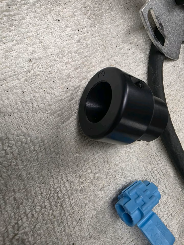

25 Sep 2026 04:44Hey Joe, can I suggest you take that blue skotchloc connector and throw it as far as your big German engineers arm will allow (they are total shite !!!!)I’m really curious to see how this turns out: I bought a used Dyna S ignition system today. It was pretty cheap (obviously—otherwise I wouldn't have taken the risk), so let's see what to expect and whether it actually works

Hi Guy,
These pictures just show the seller's entire product range!
Thanks for the recommendation, but fortunately, I’ve known for decades that those "quick connectors" are absolute rubbish! ;-( Anyone who trusts those electrical parts will eventually learn the hard way... I used them myself back in my younger days, but I always ended up paying the price for it eventually!!!

Just a quick update/bit of feedback:
The ignition system arrived today... installed it right away... and: the right-hand pickup is faulty—short circuit in the pickup (cylinders 2 & 3)—so it's only running on 1 & 4...
The verdict: As we all know, buy cheap, buy twice
I'm going to see if I can buy a replacement pickup somewhere...
