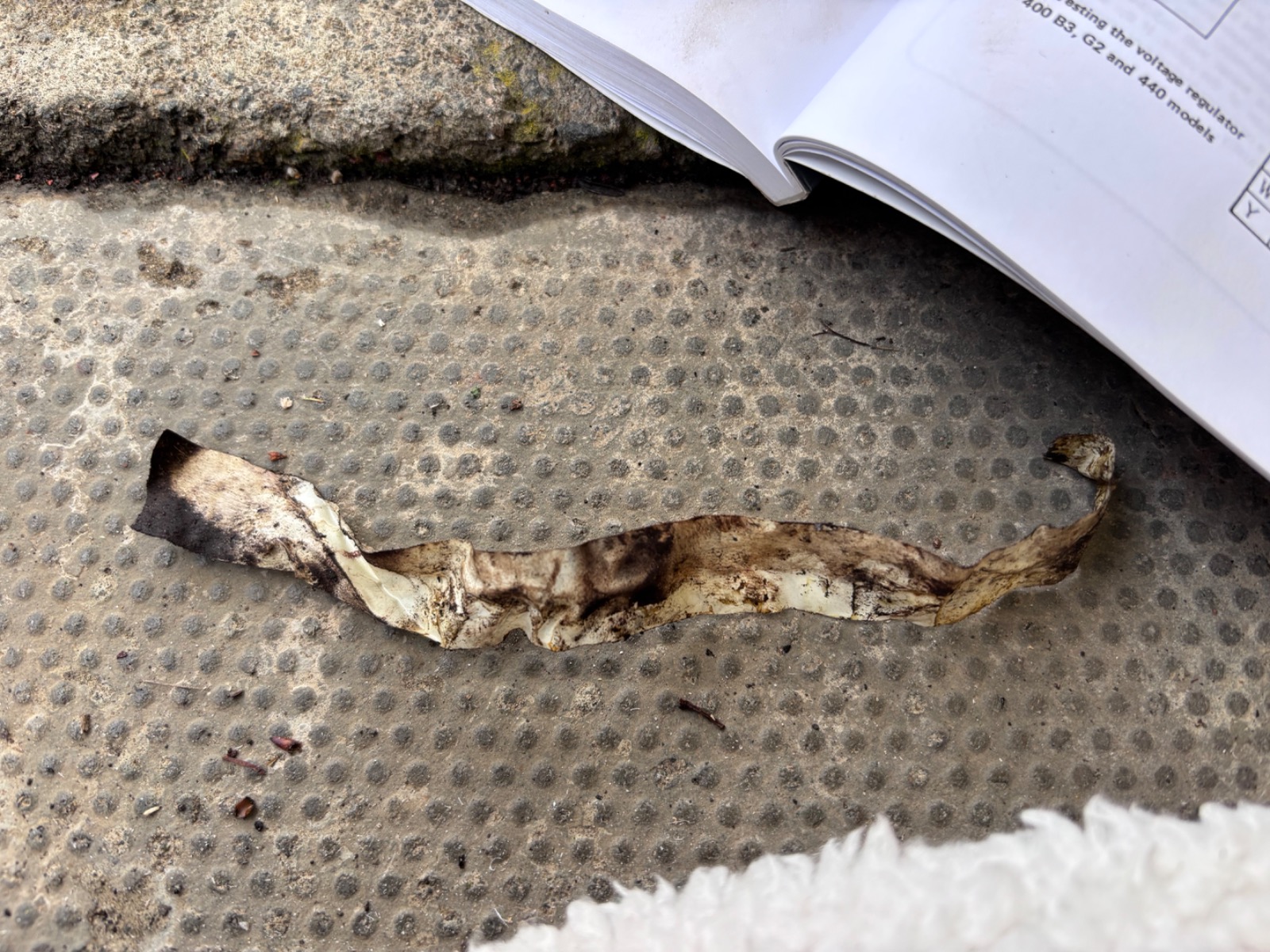

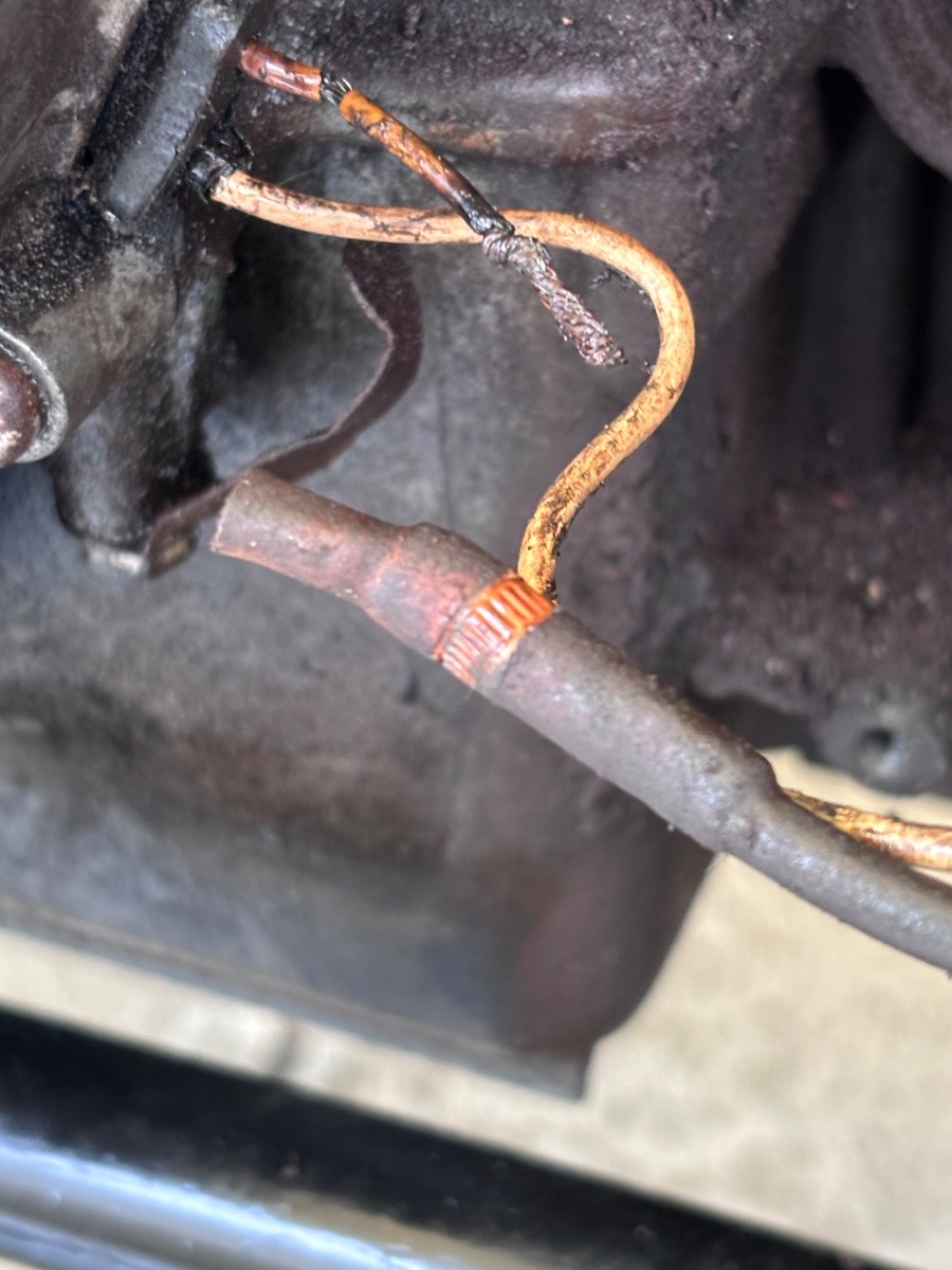

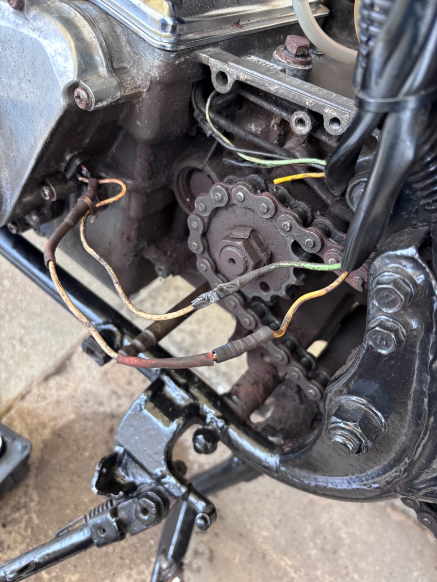

Removing the pulley cover I discovered some poor wiring. Some blackening too on white insulation tape and on the wiring.
I separated the ‘yellow’ wiring and measured 88V AC from the alternator at 4000 rpm.
Resistance between each of the yellow cables in turn from the alternator and ground measured infinity.
I’m unhappy with the wiring so I will sort that out. If anyone knows the # of strands required in each wire from the alternator I’d appreciate it tho I think I can figure it out.
One question: one of the yellow alternator wires is cut back almost to the entry point through the grommet to the alternator. It is also partly severed. If I can remove the alternator cover (there are at least 4 badly chewed screws so I am not hopeful at this point), can I replace this yellow cable readily where it terminates on the alternator?

If you can't get the chewed up screws out with an impact, drill the heads off with a left hand drill bit. The screws usually start unscrewing from the heat just before the head pops off. If they don't there's enough screw left after pulling the cover to work with. Most of the time you can unscrew the remaining part with your fingers.
