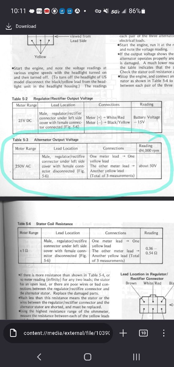

actually... i just discovered hours later
your 50v AC output is normal..

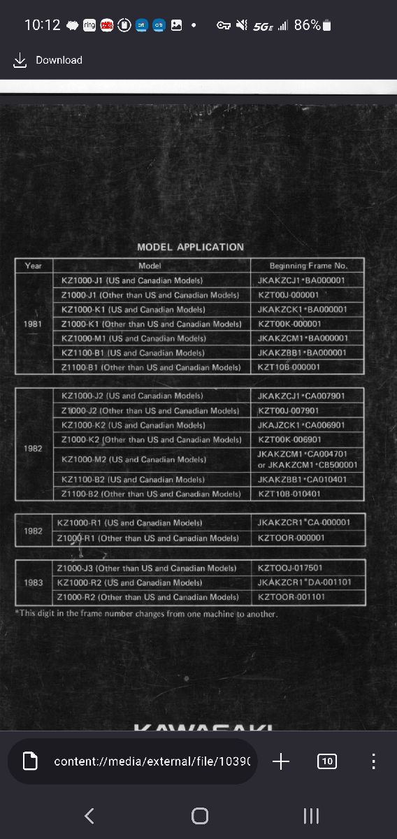

Your service manual from 1978 does not give a spec for AC output...
but the service manual for 1981-83 does.
and 50v AC is normal at 4000rpm.
