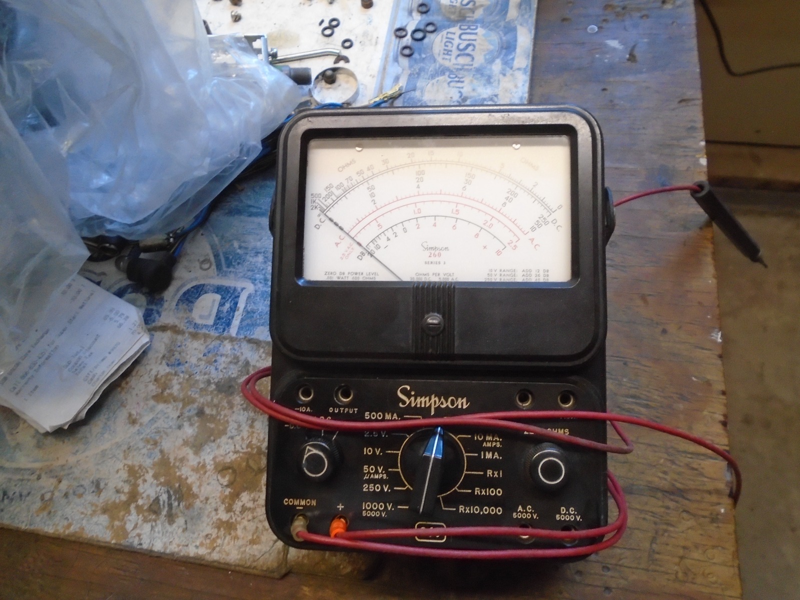

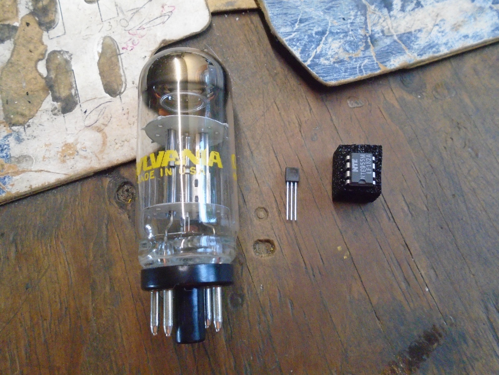

Exactly as Wookie stated!! Being an idiot means you didn't try. Now You've gained knowledge of the system and to Never take anything for granted. NOBODY is infallible, regardless what person's want to jam up your stovepipe. With all that free time and not having to get your fingers grimy anymore, study up on the operating principles of that VOM! I still have my old Simpson from back when i was a teenager. And Several pieces of test equipment that used Vacuum tubes ha. Have Fun!
