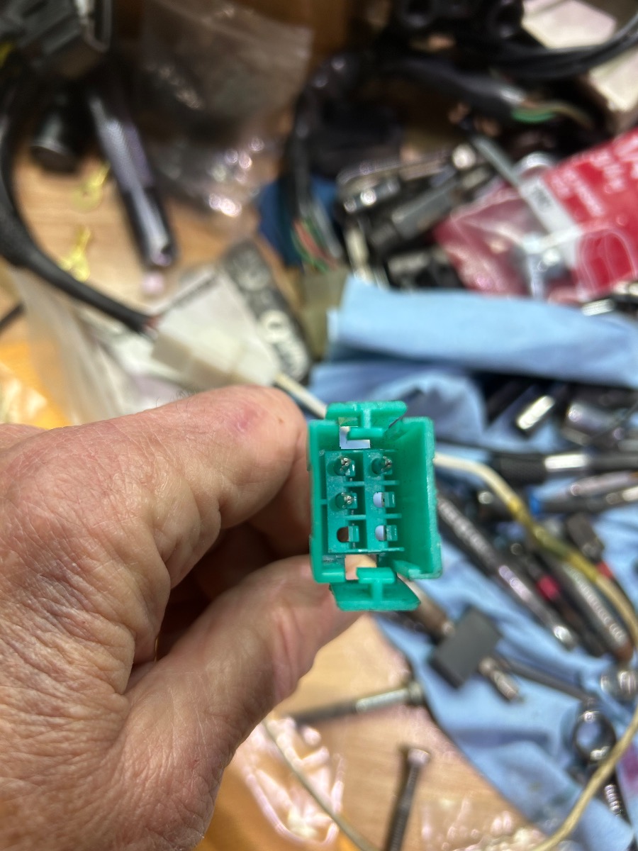

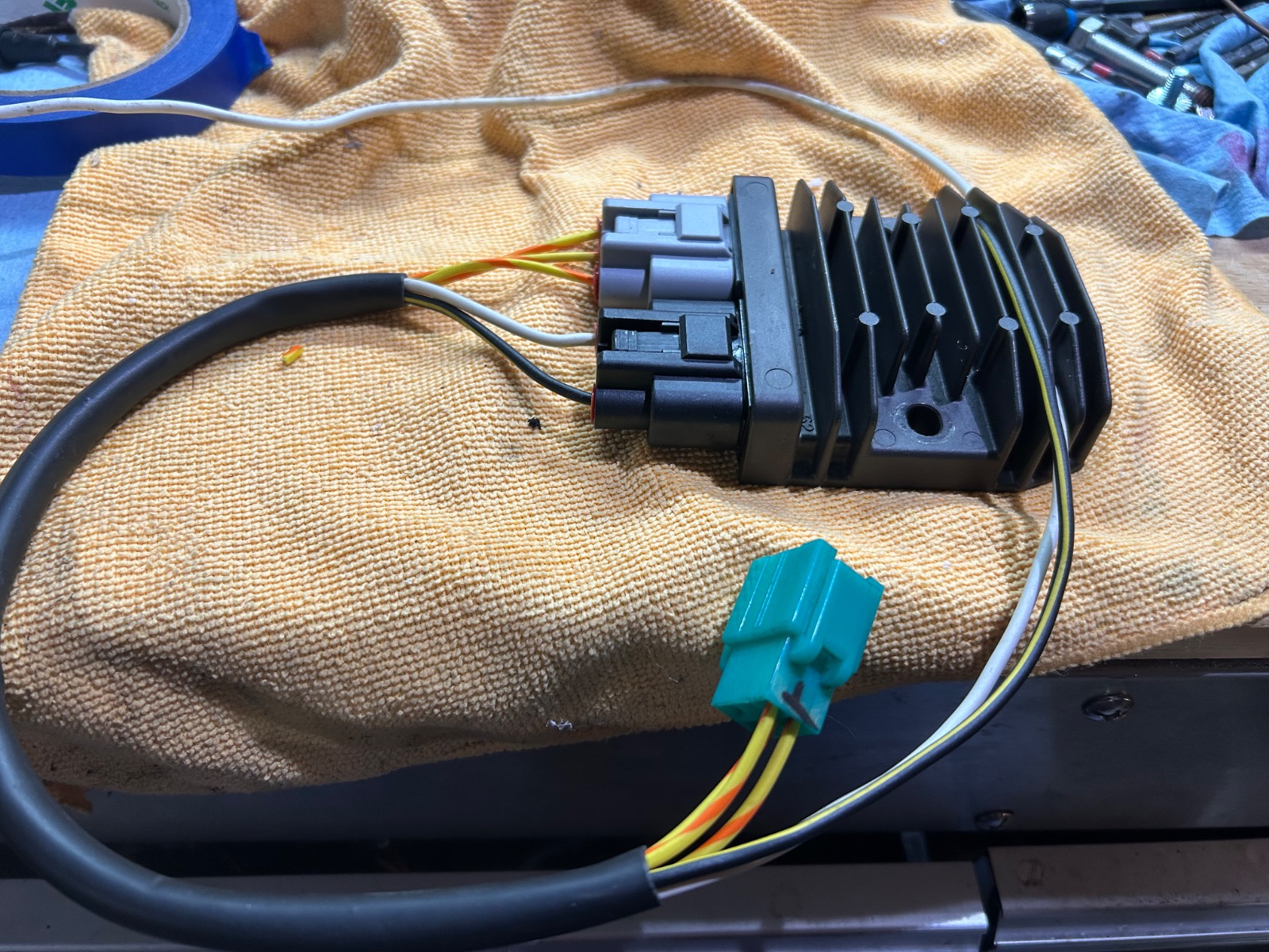

Morning, installed on 900 over winter, after agm died and regulator showed 15v+, made up harness with  proper plugs, 14.4v all the time, at any rpm, also installed in 650 a few years ago, on 900 bolts right up under,battery, not difficult, have fun

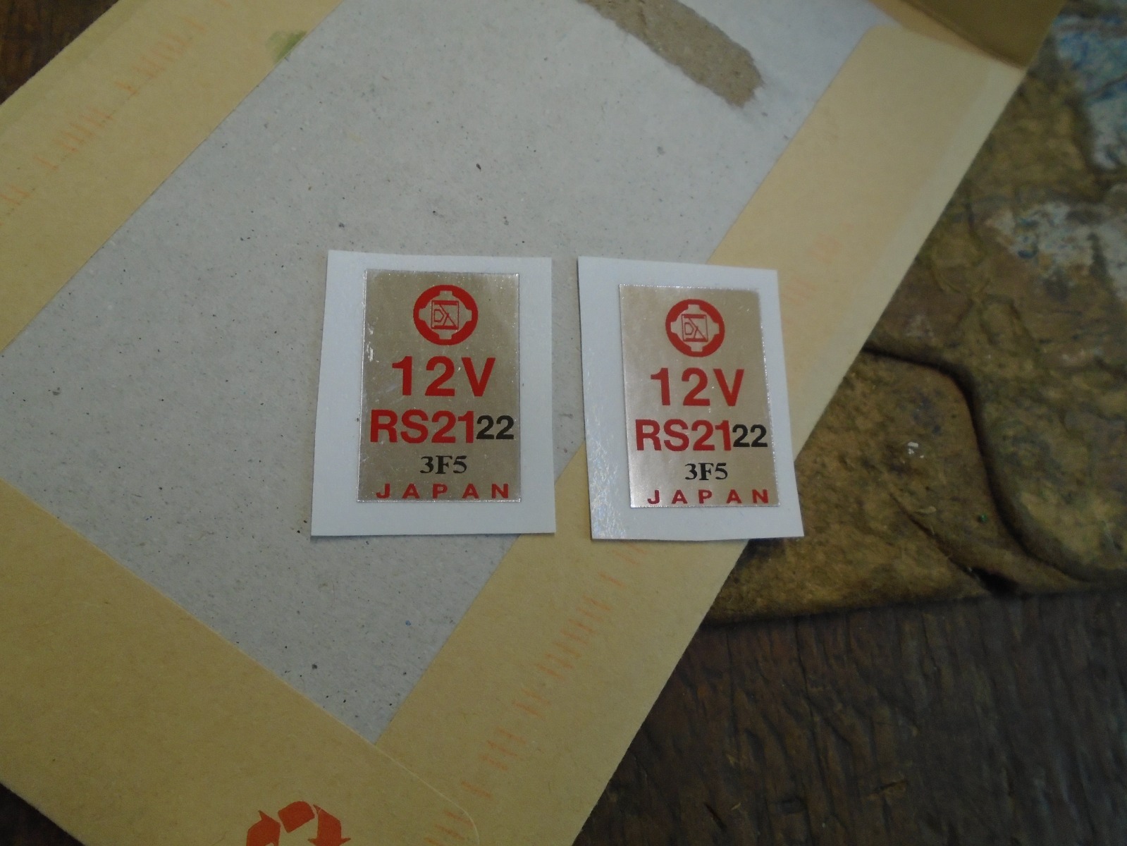

SlimJim, actually there are ways to distinguish the differences between the supplied Regulator 3-phillips screw Z1 Kokusan different RS21's beyond just a missing sticker. I only used the earlier pictures as reference, KZ Regulators only had ONE phillips screw.
