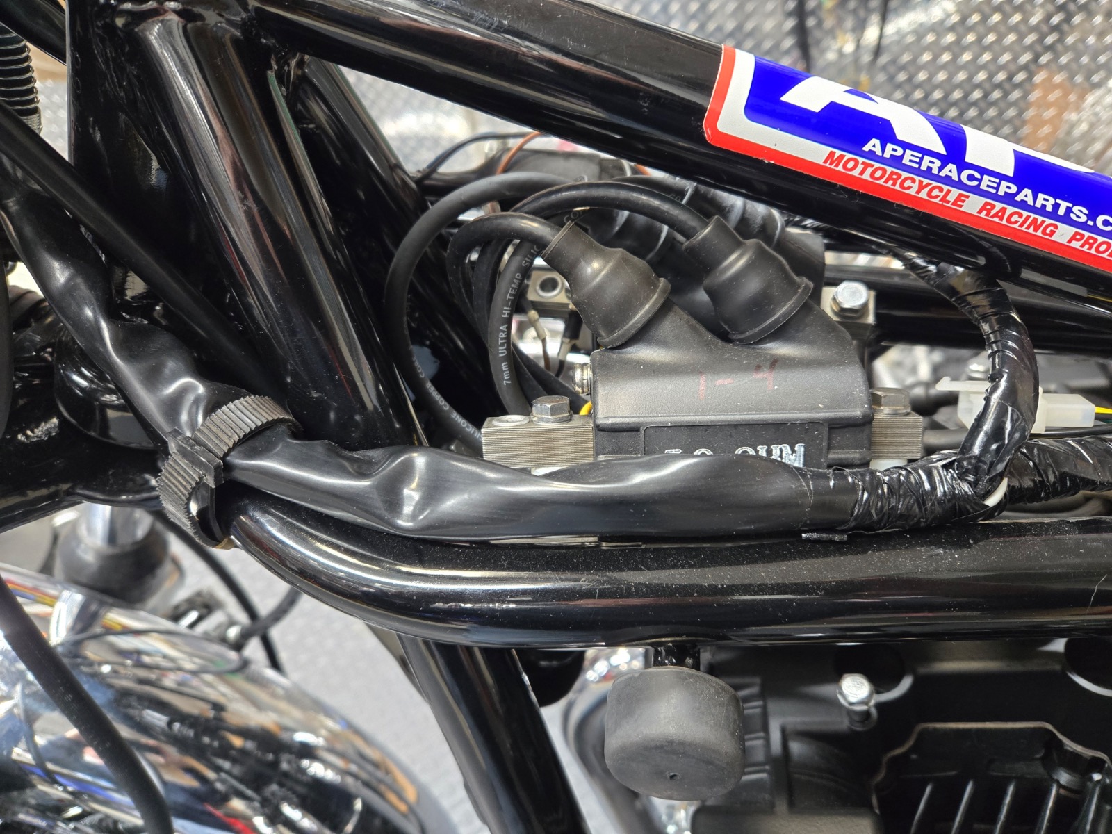

The Dyna 'S' uses 3 to 5 ohm coils.
They state 3 ohm ( the Green coils ) for racing and 5 ohm ( their Black ones ) for road use.
The 3 ohm coils produce a stronger spark and consequently run hotter which is why they list them for racing due to an apparent shorter life span but i run the 3 ohms on all my Zeds ( either 3 ohm greens or paired 1.5 ohm orange ones in series for my 8 plug heads ) for the past 40 years and never had any fail yet.
I don't know anyone who has actually bothered to fit the Black 5 ohm ones..
