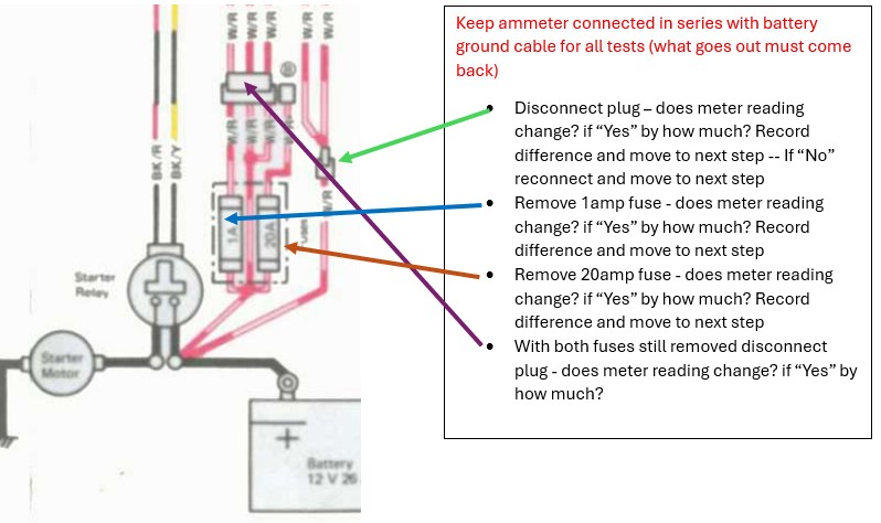

Hi Bill, complete the below and let me know what your findings are (this should isolate which circuit the drain is on)

The one amp fuse interrupted it. Need I go further?
Bill

15 Dec 2025 07:55Not for now, let me look at what that does and I will get back to you with next stepsHi Wookie,

15 Dec 2025 08:47If you take everything out of the diagram to isolate this line it goes to the drive computer and the LCD dash display. You can unplug these one at a time to split which is drawing current (I suspect it will be the dash display if it has a digital clock as these often require a constant live to maintain the correct time. If that is the case I think it's a "characteristic" rather than a defect)Hi Wookie,

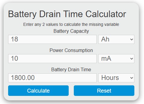

16 Dec 2025 01:20I think the fact that these items have a "constant live" would suggest there will be some current draw. Are you using an analogue or digital meter ? You can use the below calculator to work out discharge time for your battery but 10ma should take 75 days to fully discharge an 18ah battery so I would still expect it to have enough to start after a couple of weeks. If the drain is indeed 10ma and the battery is discharged after a couple of days I would suspect the battery has reached "end of life" (don't want you to go mad looking for a fault that isn't there)KZQ post=919847 userid=1568Wookie58 said: "If that is the case I think it's a "characteristic" rather than a defect"
