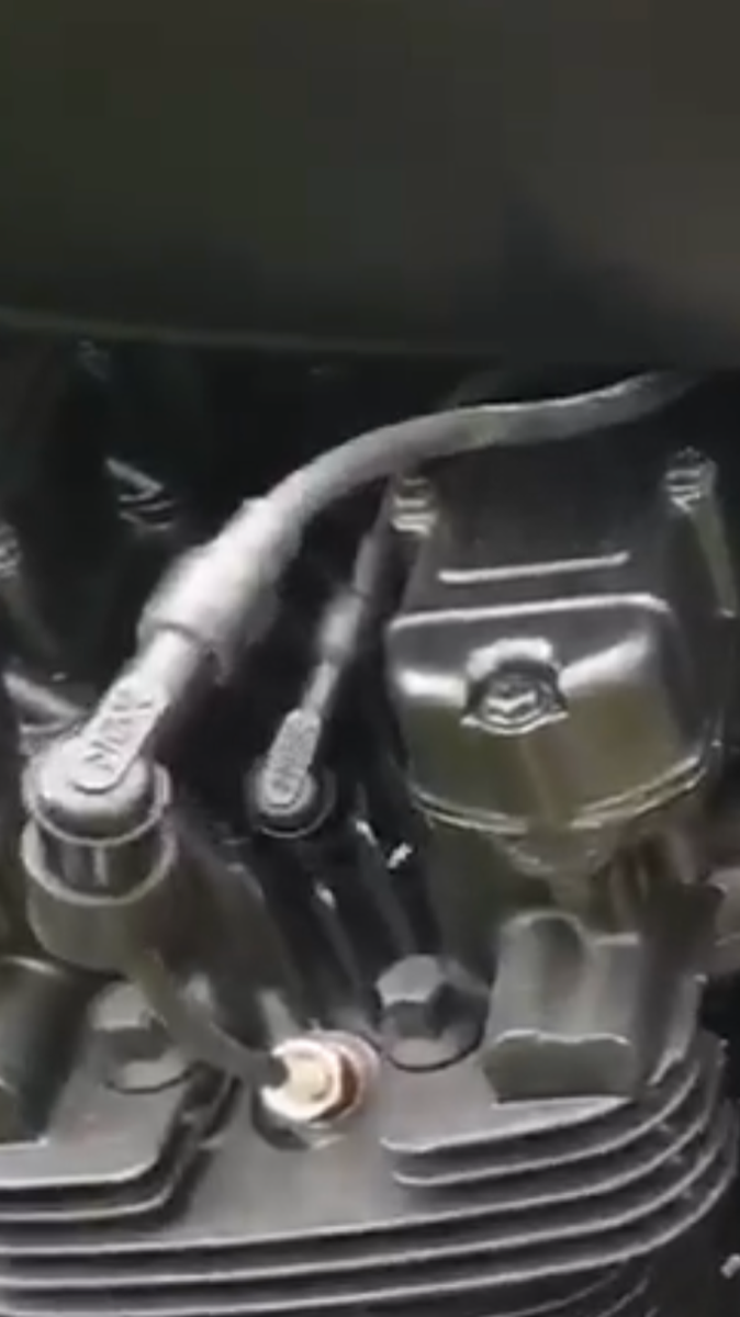

I don’t have the bike with me. This is the best picture I can find!! It is freshly Dyno tuned, but Im wondering if I should get new wires..
Kz750e 1980
- Posts: 8057
- Thanks: 3443
Re: Kz750e OHMS sparkplug wire
17 Sep 2024 17:03
If the dyno showed no misfire, and good power, new plug wires are not a critical need at this time. Personally, I'd change them, though. I'm repeating myself, but 7mm wire with a copper core is what Kawasaki used, and it's hard to argue against them in favor of any other wires. Check your plug caps using an ohm meter; they should show 5k ohms. If more, I'd replace them also.
