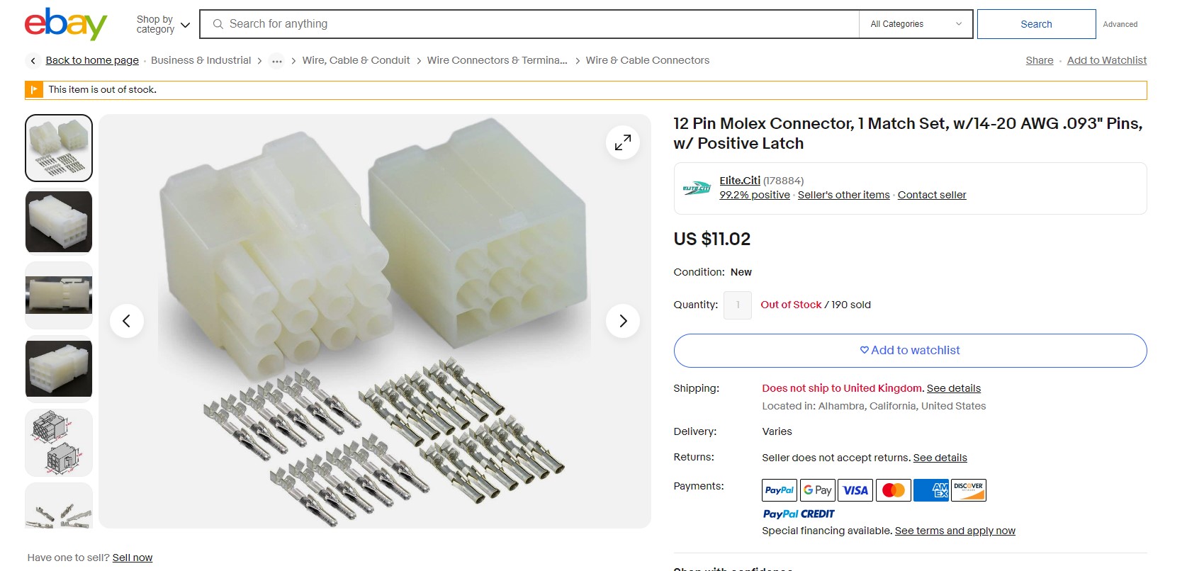

Would something like this get you what you need (2.3mm) buying a "plug kit" to get the pins may be the easiest way ??

Sounds like 2.3 would be too large and difficult to plug into the female receptacle, unless I'm measuring wrong. Can someone please clarify exactly how this dimension is arrived at? I thought that it would be the diameter of the pin, that is, the contact portion of the terminal. Just guessing.
I would have thought that by now others have been down this road.

I finally heard back from Z1 E. Thay tell me that their pins measure 2.3mm and "We have been selling those pins for years and have not had any customer issues with them.".
They should arrive in a few days and I'll be able to verify their fit in the plugs.
Thanks everyone for your insight. Wookie, looks like you were right on the money!

Lucky guess, however there is a limit to how many variations of such things are manufactured for it to be cost effective.
