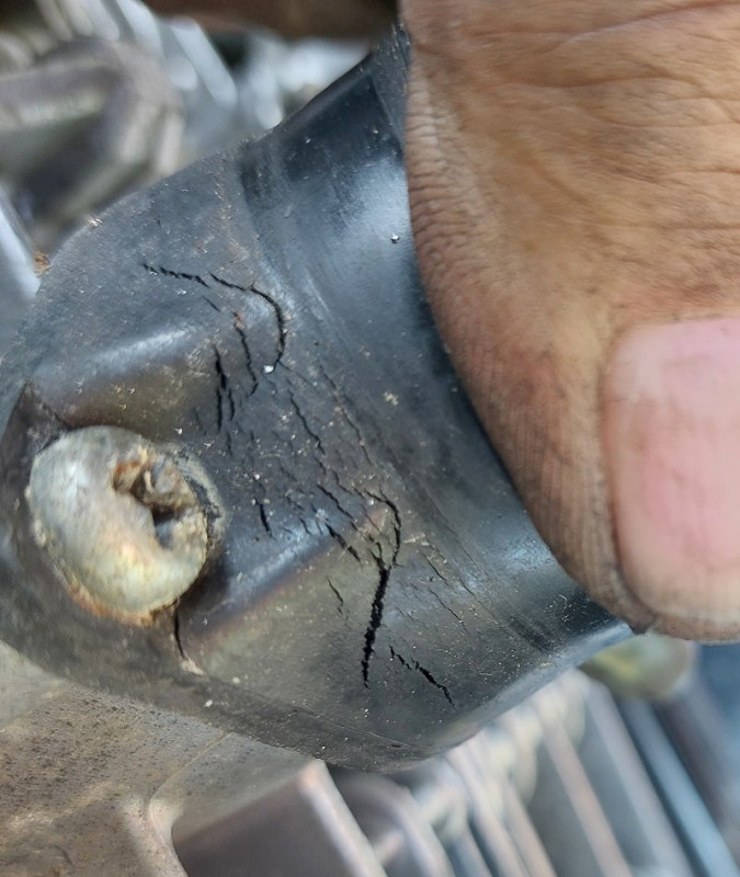

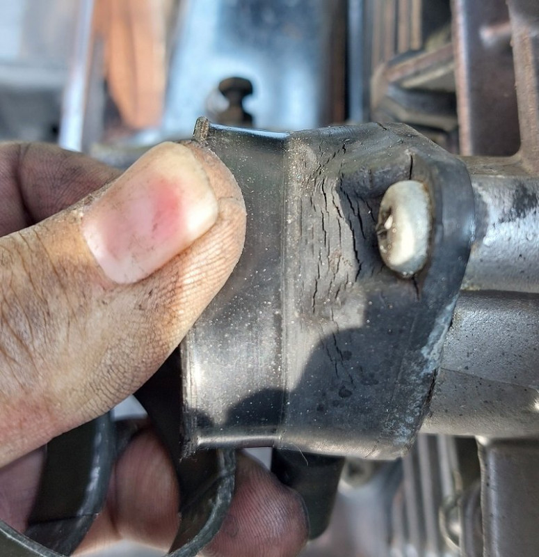

Nothing last forever. Old cracked, brittle and leaking carb rubber boots cause most of the carb related tuning problems here in the forum!
