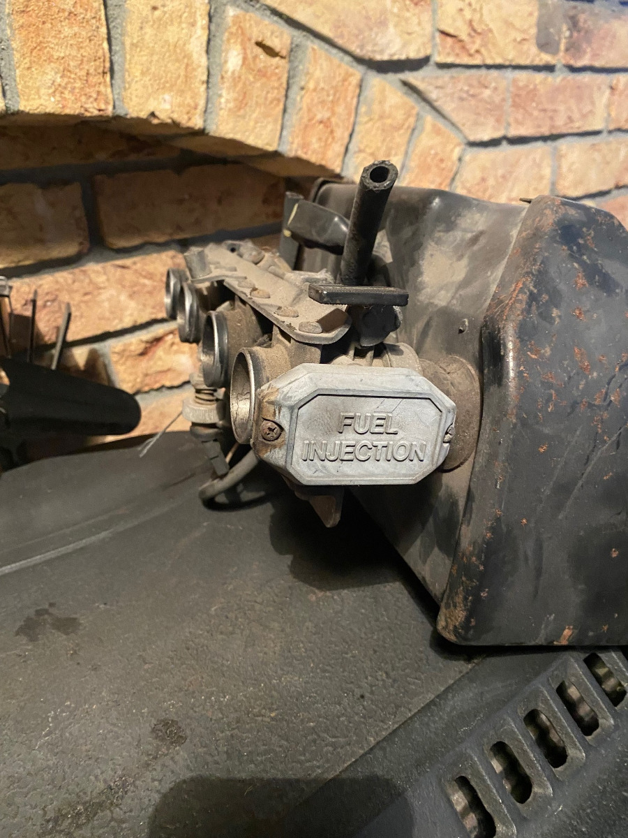

I own a pre resto Gpz1100 B1. Just went out in the dark with a flash light and what do you know....
I can take it apart tomorrow and take what ever photos that need to be taken.

So took it off and yes it is incased in resin so not sure if it will be any good as an example?

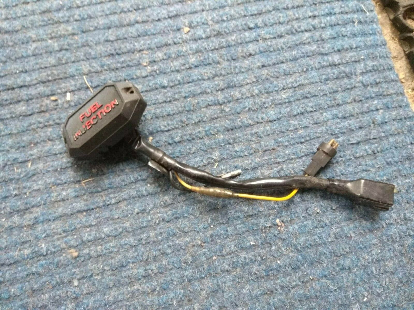

But i found the whole unit on Ebay Germany for 100 euro.
Under the heading.Fuel injection system Kawasaki 1100 GPZ b1

Looks like the smart option to me

It was possible to remove the compound by washing off the paint, the coating is very hard, no one suggested another way, the downside is that I almost ate the markings on the resistors, microcircuit or even the controller, I did not find such a thing, maybe there is a replacement, here is the marking 734d12tas2, the board itself survived, there was still a zener diode it is destroyed, ordinary 3mm indicator diodes, reed switch, magnet... It seems that the transistor is still standing on three legs, or I am wrong, there was no marking on it

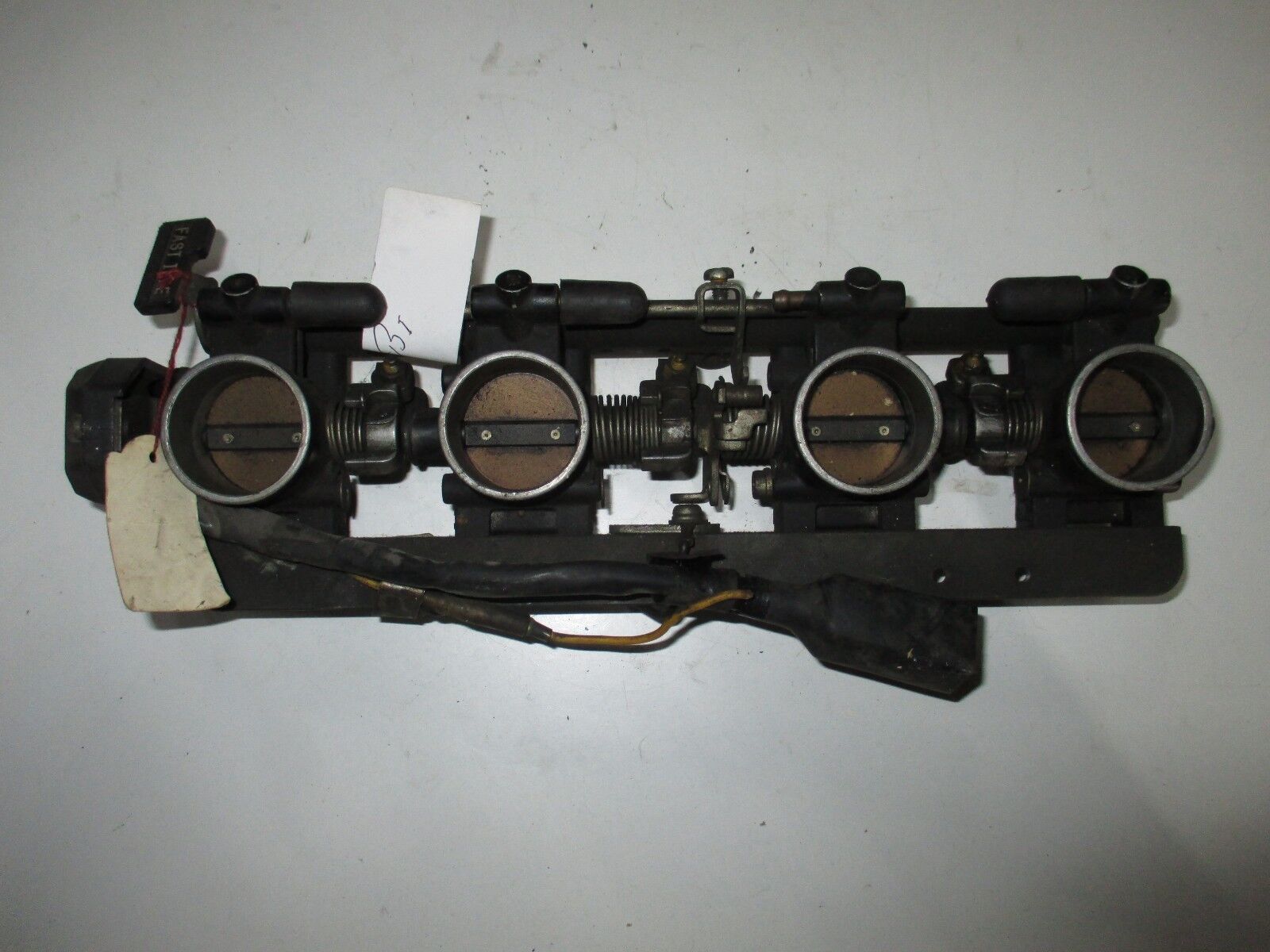

There is also another B1 on on German ebay for 45 euro.
Throttle _ switch fuel injection system Kawasaki GPZ 1100 B1 Valves-Sensor-
